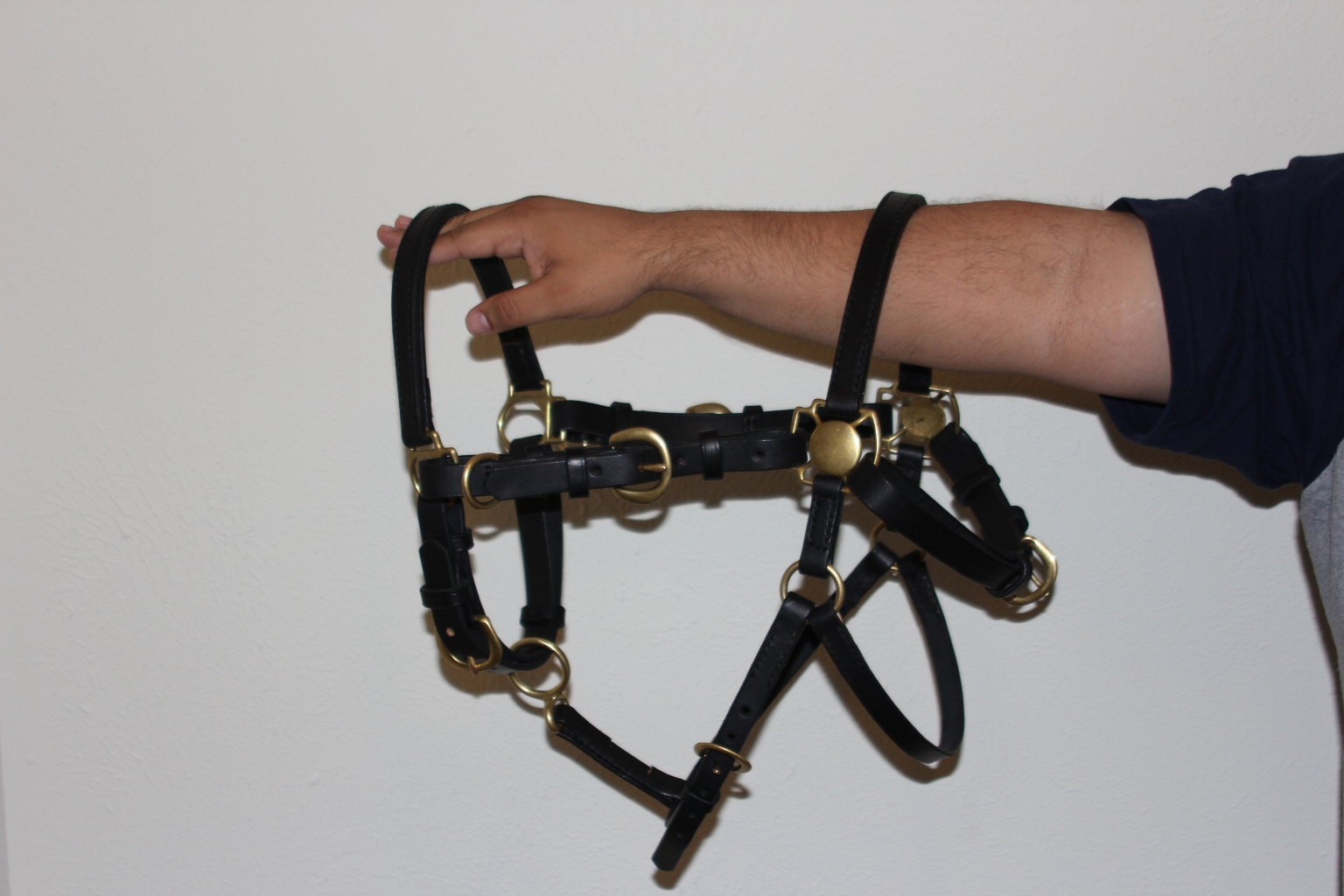

Members anester05 Posted March 15, 2012 Author Members Report Posted March 15, 2012 (edited) Thanks everyone for the replies, another question. The halters I am making right now need to be black. I have cut several straps to the widths I need. Should I make each individual piece for the halter then dye then sew the halter together? Or should I dip dye the straps then do all the cutting and sewing? Edited March 15, 2012 by anester05 Quote
