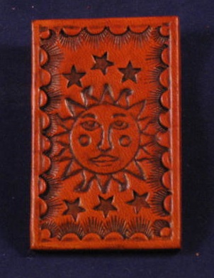

This is some Antiquing info I got from Raymond Tipton of duckcreektraders
I thought this might be of some help to others. There are many ways to add antiquing to your work.
For many different results you can put your resist over some areas, painted or not, or you can put the
resist on the entire piece and then use the antique paste. I am sure others may do this differently, with
different products - for instance sometimes I just use the antique paste to color a coaster (I love the color of
undiluted Antique Saddle tan) and then when the piece is dry I put on more Antique Saddle tan to fill in the
low spots and then wipe with a paper towel, leaving the antique in to highlight the low spots.
Please, feel free to add your tips or pictures too

The rope tool was made by Raymond Tipton of bunkhousetools and he used his emboss roll #164
post-15330-067215600 1334813110_thumb.jp
It is really cool how he did that, because you can't tell where he started and where he ended with the emboss roll.
post-15330-076750300 1334814067_thumb.jp
:thankyou:
Please, feel free to add your tips or pictures too. I learned a lot from this tutorial, and like Bluesman said "The combinations are endless"

Thanks a lot for the tips. Tried it yesterday and like the way it works. I did two pieces to test. I used Fiebings hi-liter and Eco-Flo gel, they both came out about the same after resisting (Satin Sheen) the whole piece.
The piece on the right is hi-liter and gel antique on the left. Both are Saddle Tan.
Have to figure out how much resist to put on to get background darker. Just experiment to see if I can use less.
Now off to practice more, to get it where I want it.
thanks for all your help, Charlie
