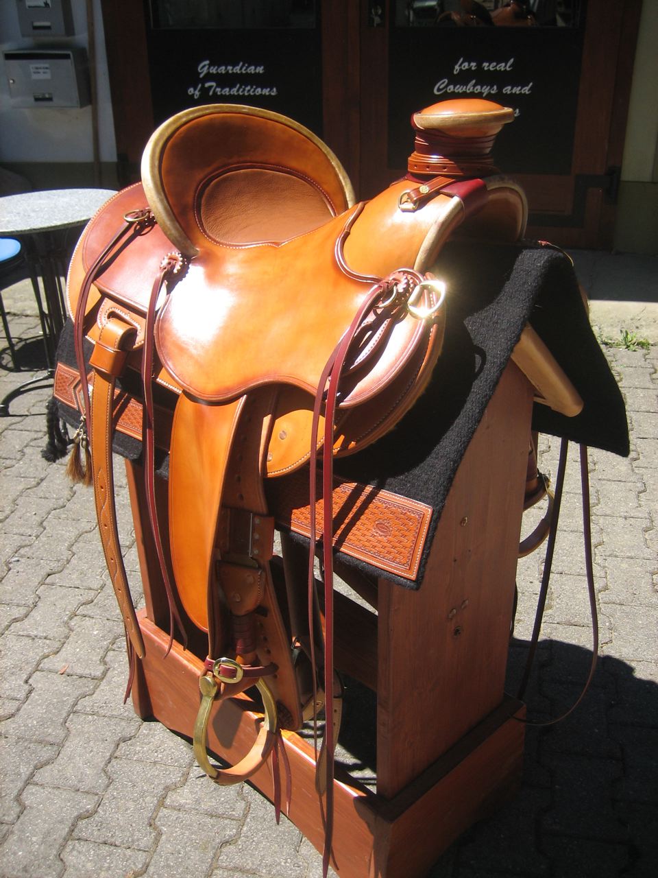

Ok - ya'll want to know about this Border Treatment - got this from another friend, so it's not an 'original' idea, but I loved it as much when I saw it the first time...comes from Pedro Pedrini - saw it first on a saddle he made for submission to the TCA last year, and, he did gain membership in that elite group by way of the workmanship, etc, of that saddle. He just called me yesterday, and was telling me that he will have to come to DFW a few days before the TCA show opens this fall in OKC, as he has been awarded the 'Saddlemaker of the Year' award - I think this is the Cowboy Artists of America org...
Anyway, the main stamp is from Horseshoe Brand Tools, and a Craftool F120 - this tool is cheap, and we buffed off the lines. I will start by deciding how far from the edge I need to run my double line, running that with a ceramic blade - then I will make a light impression with the HBT next to that line, so I know how far apart to set the dividers to mark the second double line. Run the HBT after both double lines are done - a little scrap piece helps before the real deal - then use the modified F120, and a little tap with the wider end at the base of each of the HBT impressions. Once done with that, I bevel the inside edges, then the outside edges. I've also done this border with shell tools, etc, just to change the look - IMO, not as pretty as just the double line, keeping the outside edges clean, and not distracting.
Attached is a closeup of that border treatment on the cantle, etc of that saddle....
Pretty simple - three stamp tools and a double line swivel knife...
Enjoy - SL

:thumbsup::clapping: Hello Shelly, hello everyone
This is a definitely beautiful saddle and a absolutely great story going with it. I should have discovered this great forum six months ago...!!! I finished my very first saddle three weeks ago here in Switzerland in the workshop of Pablo Ulli. It took me about a year to make my first experiences with leatherwork to start with the saddlework. It took me 5 weeks (mostly 7 day weeks) to build it. My main concern was to make a working saddle, A-fork, high cantle, round skirts, fitting most QH and Paints. I'll try to post a picture or two and maybe open a new thread with way more pictures, as I have zillions of questions...
