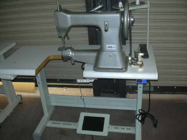

Members marcos89 Posted June 22, 2012 Members Report Posted June 22, 2012 (edited) Ok so i been thinking of getting a GA5-1(not with the R) and im having mixed feeling about it. i mainly do belts, wallets and stuff like that. In recent days i been asked to do breast collars horse tack and hopefully one day move up to saddles BUT i dont know if this machine is right for me. I want something a little versatile that i can do some "light" projects yet it can tackle 3/4' projects. according to the specs it will sew 1/2 inch and the foot can be raised up tp 3/4 of an inch. im fairly new to sewing machines and im not really sure if this would be something that i could use for light and HEAVY projects. I know people say dont base your purchase on money but when the money aint there well it aint there no matter how much you want it to be. Who has a GA5-1 and can give me a review on the machine. how well it works and how thick in your personal experience have used it for? thanks Marcos Edited June 22, 2012 by marcos89 Quote
Moderator Wizcrafts Posted June 22, 2012 Moderator Report Posted June 22, 2012 Marco; I don't have a GA5-1, but I have spoken to dealers who sell that type of machine and all seem to agree that it is maxed out even sewing 7/16 inch. I have never seen a spec that shows the presser foot being able to lift over 1/2 inch. Would you mind providing a link to the machine you are considering? Quote Posted IMHO, by Wiz My current crop of sewing machines: Cowboy CB4500, Singer 107w3, Singer 139w109, Singer 168G101, Singer 29k71, Singer 31-15, Singer 111w103, Singer 211G156, Adler 30-7 on power stand, Techsew 2700, Fortuna power skiver and a Pfaff 4 thread 2 needle serger.
Members marcos89 Posted June 22, 2012 Author Members Report Posted June 22, 2012 (edited) Marco; I don't have a GA5-1, but I have spoken to dealers who sell that type of machine and all seem to agree that it is maxed out even sewing 7/16 inch. I have never seen a spec that shows the presser foot being able to lift over 1/2 inch. Would you mind providing a link to the machine you are considering? heres a link of the ebay post. this person is 2 hours away from where i live and i wanted to go check it out but before i went i wanted to do as much research as i could. it states that it lifts up to 3/4 of an inch on the post but i been getting mixed reviews online. http://www.ebay.com/itm/HEAVY-DUTY-SADDLES-HARNESSES-Cylinder-Bed-SEWING-MACHINE-LEATHER-BUSTER?item=251056380627&cmd=ViewItem&_trksid=p5197.m7&_trkparms=algo%3DLVI%26itu%3DUCI%26otn%3D5%26po%3DLVI%26ps%3D63%26clkid%3D99449558345895772 thanks Marcos Edited June 22, 2012 by marcos89 Quote
Moderator Wizcrafts Posted June 22, 2012 Moderator Report Posted June 22, 2012 (edited) it states that it lifts up to 3/4 of an inch on the post but i been getting mixed reviews online. http://www.ebay.com/...449558345895772 thanks Marcos The 7 dimes, at about 1/16" each, show the actual maximum lift and sewing thickness you can expect in the real world. The type of material will have an impact on how much higher you can cheat and pre-raise the presser bar. If you have to sew 5/8 inch of nylon webbing, or buffing wheels, you can loosen a set screw on the foot bar clamp and raise the foot to clear that much material. In return, you will have about 1/8+" of free space under the raised foot. If you need to sew something thin, you'll need to reposition the foot. The spring used to hold down the foot is not heavy enough to keep 1/2 inch of veg-tan leather from lifting with the needle. When the needle gets stuck, you have skipped stitches. The feed is bottom only, via feed dogs with serious teeth. The more top pressure you apply, the deeper the tooth marks will be. The needle system used in these machines normally starts at #22, which is the right size for #138 thread. If you want to use thinner thread, into thin wallet parts, you must hunt down thinner needles, in size 18. You can learn more about these machines here Here is another GA5-1 Edited June 22, 2012 by Wizcrafts Quote Posted IMHO, by Wiz My current crop of sewing machines: Cowboy CB4500, Singer 107w3, Singer 139w109, Singer 168G101, Singer 29k71, Singer 31-15, Singer 111w103, Singer 211G156, Adler 30-7 on power stand, Techsew 2700, Fortuna power skiver and a Pfaff 4 thread 2 needle serger.
Members marcos89 Posted June 22, 2012 Author Members Report Posted June 22, 2012 The 7 dimes, at about 1/16" each, show the actual maximum lift and sewing thickness you can expect in the real world. The type of material will have an impact on how much higher you can cheat and pre-raise the presser bar. If you have to sew 5/8 inch of nylon webbing, or buffing wheels, you can loosen a set screw on the foot bar clamp and raise the foot to clear that much material. In return, you will have about 1/8+" of free space under the raised foot. If you need to sew something thin, you'll need to reposition the foot. The spring used to hold down the foot is not heavy enough to keep 1/2 inch of veg-tan leather from lifting with the needle. When the needle gets stuck, you have skipped stitches. The feed is bottom only, via feed dogs with serious teeth. The more top pressure you apply, the deeper the tooth marks will be. The needle system used in these machines normally starts at #22, which is the right size for #138 thread. If you want to use thinner thread, into thin wallet parts, you must hunt down thinner needles, in size 18. You can learn more about these machines here Here is another GA5-1 thank you for your feed back it help to understand all this alot better =D Quote
Techsew Ron Posted June 25, 2012 Report Posted June 25, 2012 I should warn you, most people who make the mistake of buying this machine from one of the ebay drop-shippers end up calling me a week later looking for replacement parts, accessories, instruction manuals and technical support since the seller doesn't offer any of these. Keep in mind the few hundred in savings will easily be spent on getting a technician to set up your machine properly, accessories that aren't included, replacing parts that break (if you can find them) etc.. Buying it from a reputable dealer will save you MANY headaches. Ron Quote Techsew Industrial Sewing Machines Call toll-free: 866-415-8223 Visit www.techsew.com
