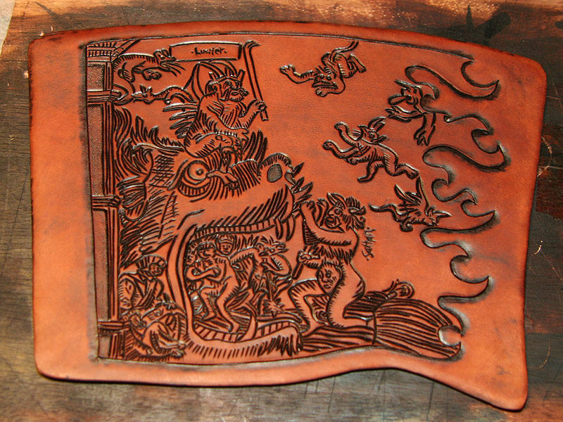

TomSwede Posted July 27, 2008 Report Posted July 27, 2008 This is the pattern I use to make my archers bracers. The only fun part with this bracer is to view the final result. It is stringed together at the side of the arm. It is made as a right or left arm piece. I use tracing film to trace cutting pattern over from this sketch so remember to flip the film upsidedown if you want to make a right arm piece. THIS IS A LEFT ARM PATTERN!!! Sizing: The original to this one is to fit an arm wich is about 19cm (7,4") diameter and you can see the mark for Cris is 17,5cm (6,8") so for that bracer I just cut the marked edge off from the original to fit his arm and make sure to follow the hole lines to mark out the stringing holes accordingly. If one want's to make it smaller in diameter than Cris version it'd be wise to scale it down a bit (thus sacrificing height) Since the curled line on the inside arm may not align properly to the wrist contour. Tooling designs: I just think it's a nightmare to setup this one with the artwork since I don't draw very well thus depending on "borrowing" art. Because of the height of this one the artwork I find will most often go around to the inside of the arm and most art work is based upon centered designs so it's hard to find designs that'll display nicely once it's formed to the arm. So i always end up spending hours with just finding the right tooling artwork. Wetforming: I just think this one deserves to have that performed before shipped off to customer since it's important to make the top and bottom edges curled up. The bottom edge will not be very comfortable if not curled up and top is just to complement bottom curl. I just string it wet (cased, cool to touch and put eyelets in before stringing) onto myself and sorta pinch the edges between my thumb and index finger and curl it up. WATCH OUT FOR DIGGING YOUR NAILS INTO IT! Once I'm satisfied with the look and feel of the edge I just slide a finger in between the leather and my skin and pull it under the edge every now and then to prevent it from falling back during the drying process. I keep it on my arm for about 2-3 hours. This design with the curled edge benifit a whole lot from having a tooled border IMO. ENJOY Quote
TomSwede Posted July 27, 2008 Author Report Posted July 27, 2008 (edited) A few pics. Edited July 27, 2008 by TomSwede Quote

Members sodapop Posted July 27, 2008 Members Report Posted July 27, 2008 hey tom...good stuff man!!...ya answered one of my questions i was gonna ask ya after seein the one ya did for pog...heres a question i have...when your looking at the pattern...on the bottom left of the pic...whats the reason/purpose for that indented area?? darryl Quote
TomSwede Posted July 27, 2008 Author Report Posted July 27, 2008 Thank you guys! The bottom line follows the contour of the arm and the bracer against the hand and that part is extended to allow you to string it tigether there. One could place the stringing holes upwards and cut down that part but my guess is the whole bracer would just ending up higher on your arm wich spoils the general idea of this one to really marry and reinforce your wrist yet provide some movement there. This bracer works just as good for the hand holding the bow aswell as the releaser hand. Tom Quote

ArtS Posted July 27, 2008 Report Posted July 27, 2008 Awesome! I really like the shaping and the coloring. The gold on that one really looks good. ArtS Quote

Members Meleck Posted July 28, 2008 Members Report Posted July 28, 2008 It's a very nice pattern that I might poach. Always wondered how I would set-up an archery bracher that had the string aligned with the pinky finger. Your Thor hammer bracer looks great. I think the colors look great together and the carving is n_i_c_e. I would be awefully proud to own that one. Quote

Members cem Posted July 31, 2008 Members Report Posted July 31, 2008 Thankyou Tom for the pattern and explanation, my partner saw that raw picture when i was looking at your blog and decided that I would be making him one. I really loved that Raw look on your latest bracer, but it's definately come up really well with the gold and bronze on the black. Thanks again Cheers, Clair Quote
TomSwede Posted July 31, 2008 Author Report Posted July 31, 2008 Thank you C79 and Clair! Are the used for any special reason in the cowboy world (like mine is really for archers) or just decorative? (I make mine mainly for good looks, 1 archer so far). I agree with you Clair but being a heavy metal man myself I just have to live with making some black. Metallics are very good to accent the tooling with since they apply on top of the black and is not streaky either. I really liked them better naked. Glad to hear people find their way into my blog. Tom Quote
TomSwede Posted August 1, 2008 Author Report Posted August 1, 2008 I was finally able to take a pic of how this one's stringed together at the outer side of the arm. Left arm in this case. This is the smaller female version of the previous one and that's why there's such a huge gap in the stringing area. It looks fine this way too but we've talked about the contours of this bracer to marry the joint against the hand and that's where this one fails to be put to use on my arm. A regular shaped bracer doesn't really need (for function) to be all away around the arm with just a small gap in the stringing area. That's just my personal pref and I have had customers requesting a huge gap since they love look of the crossed stringing. tom Quote

Members Freddo Posted February 21, 2009 Members Report Posted February 21, 2009 I was finally able to take a pic of how this one's stringed together at the outer side of the arm. Left arm in this case. This is the smaller female version of the previous one and that's why there's such a huge gap in the stringing area. It looks fine this way too but we've talked about the contours of this bracer to marry the joint against the hand and that's where this one fails to be put to use on my arm. A regular shaped bracer doesn't really need (for function) to be all away around the arm with just a small gap in the stringing area. That's just my personal pref and I have had customers requesting a huge gap since they love look of the crossed stringing.tom Tom, I love the work! What type of leather are you using and what weight? Ever considered lining the inside? Fred Quote
Members DG Leather Posted March 20, 2009 Members Report Posted March 20, 2009 I too am curious about what leather and gauge was used! Tom,I love the work! What type of leather are you using and what weight? Ever considered lining the inside? Fred Quote
TomSwede Posted March 20, 2009 Author Report Posted March 20, 2009 (edited) Thanks all for the kind words!!!! I use veg.tan leather and and 2,5-3mm thickness, that is about 1/10"-1/8 in thickness in inches but what weight??? PLZ help me out someone who's more familiar with the subject of American standars and units. In Sweden we use metrics only with the exeption of measuring leather in sq.ft. I have considered lining them but customers doesn't seem to care and I seldom do stuff that is not to be sold. I did line the small braided bracer I did for myself and I really love it. So smooth and nice on the inside. I used the thinnest available cowhide for that. Tom Edited March 20, 2009 by TomSwede Quote
