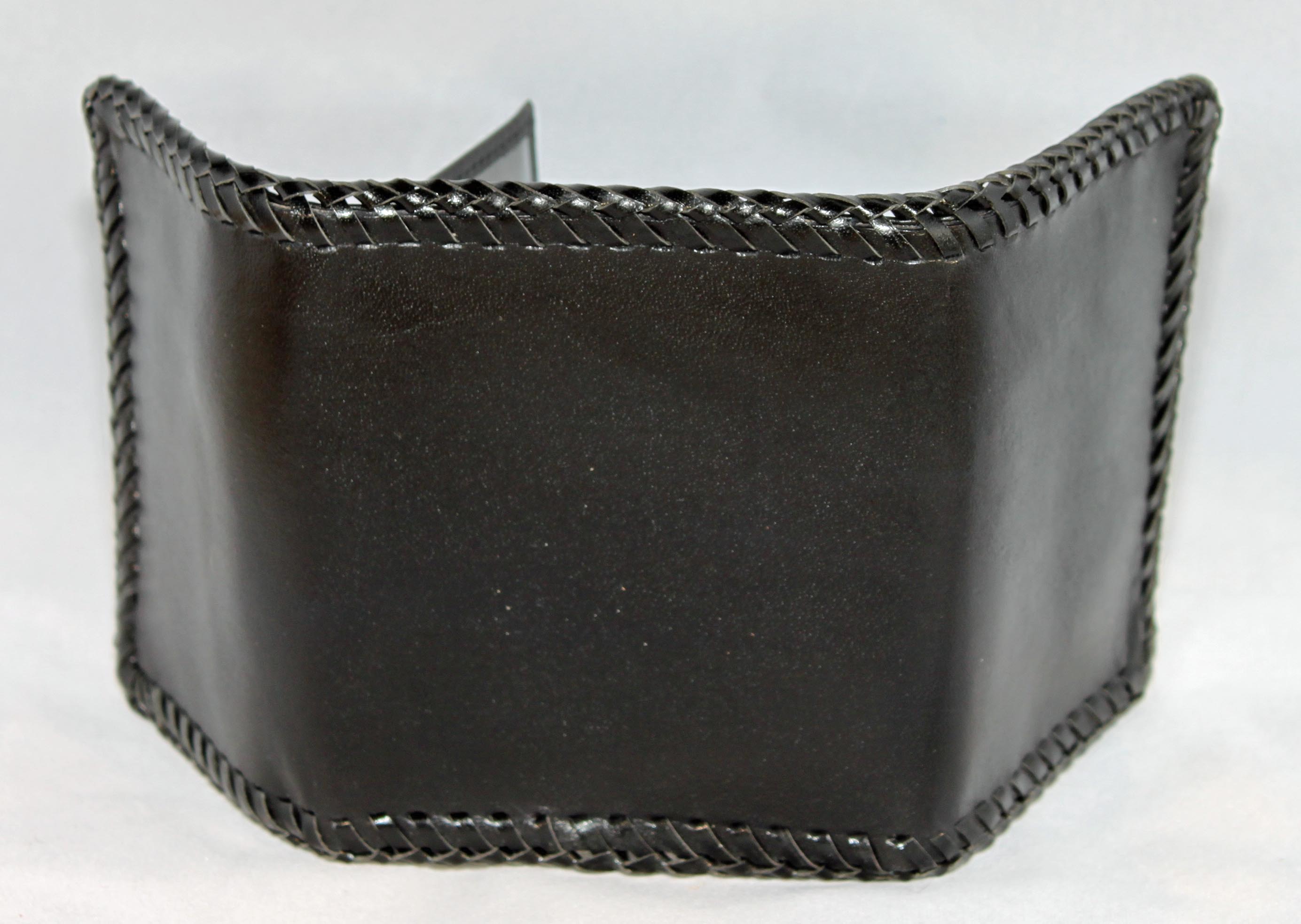

Chief31794 Posted August 10, 2012 Report Posted August 10, 2012 (edited) I can tool wallet backs for practice for months, but there's nothing to put in them. I don't have a sweing machine so the Chaylor Finielli inserts are not a possibility. Idealy, I'd like to make my own from calfskin. So, does anyone know of a book that covers the making of the insides, or a source for "Tandy-like" insides that have encough room for hand sewing or lacing. The Chaylor Fenelli inners from Springfield can be laced, I lay out the lacing slits with a thonging chisel. They can be laced or sewn by hand, below are pictures of one I made with a Chaylor Fenelli inner. Ken Edited August 10, 2012 by Chief31794 Quote "Life's too short to carry ugly leather"

Members DrGull Posted August 11, 2012 Author Members Report Posted August 11, 2012 The Chaylor Fenelli inners from Springfield can be laced, I lay out the lacing slits with a thonging chisel. They can be laced or sewn by hand, below are pictures of one I made with a Chaylor Fenelli inner. Ken Ken: That's Quite Impressive, I don't know whaere you found the room. Maybe it varies from insert to insert, because the one I ordered didn't have any room for stiching, it would have cut off the cradit card slots. Thanks again for the pictures, ---Todd Quote
