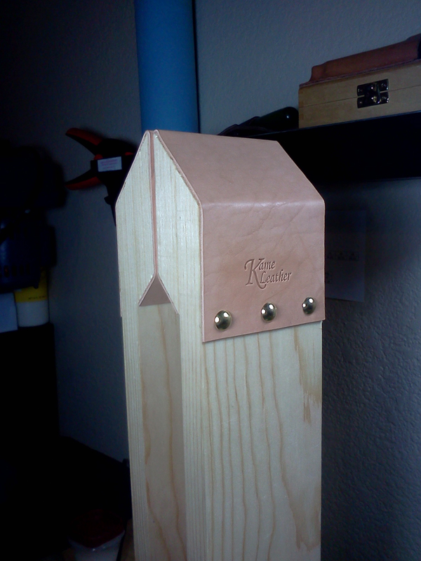

Finally got around to making my own stitching pony. The small one that I bought from Tandy a few years ago just wasn't cutting it anymore. This one is just the right height for me, so I can clamp it to the top of my work bench and stitch standing up or sit with it under my legs and have it right at chest level. No more sore back from stooping or hunching over. I bought everything in 1 trip to Lowes (the leather was 2/3oz that I had lying around). Total cost was less than $25 and took me about 2 hours with a hand saw and miter box. I chose not to seal it because I'm lazy.
post-16368-0-71317900-1349070744_thumb.j
post-16368-0-09184400-1349070754_thumb.j

That clinches it. I'm making my own tomorrow!!! Nice job and I like the stamp.
Learnleather.com
I like this a lot . In fact even though I have a very nice sit down stitching horse ,I would buy one of these if the price was right . As a long time hand stitcher the only down side I see to this is your knob is going to catch a long string a million times. Sewing short stuff wallets and stuff will be a breeze . Send me a private message if you want to sell me one . Well done sir ,nice job . I am interested in one . Bill
nice work!
Thanks everyone for the compliments. Bluesman, I agree with you about the knob catching the string. I'm not concerned about it, since as you said, it wouldn't be much of an issue with shorter items like wallets and that is all I plan on stitching right now. I don't have any plans on selling these as the cost of shipping would skyrocket the price, but they are extremely easy to make with a miter box, saw, and electric drill.

Find out how tall you want the arms of the clamp. I'm a relatively tall guy and made mine 18" tall. (Much taller and you may need to buy an 8' board). The Base is 16" long, the two pieces between the arms at the base are 3.5" tall each and the angled pieces that make the clamp at the top of the arms are 3" each. The spring goes over the bolt in between the arms and the hex nut gets screwed the entire way down the bolt before sliding the bolt through in order to have the right length sicking out for the handle to clamp securely. The hole for the tightening bolt is about 7" up the arms from the base.
I think with those measurements, everyone should be able to figure out how to put it together. Just remember that the arm with hinge the needs to be able to swing, so only attach it to the unit through the hinge. Everything else is glued down to the base with contact cement (what I had available) and then screwed down. The angled jaw pieces at the top of the arms are screwed to the arm with the 1" screws. Screw them in through the outside to keep the screw head from making marks on what you are clamping.
The best part about this is that you can make it exactly the height you need to keep your back from hurting.
I hope this info helps anyone who wants to make one and if any of it doesn't make sense, just let me know.

The string catching on the knob is an easy fix. Just cut a triangle piece of wood that mounts under and extends just past the end of the bolt. Sand and round the edges and and glue or screw it in place. If you have a router and can sink the triangle a 1/16 of an inch even better. I had the same problem on my stitching pony and it was well worth doing. That is a nice looking pony and you will really get a lot of use out of it.

One issue I see with how these are set up is the two arms need to be spaced slightly wider at the bottom than at the top. The way they are set up when you spread them and slide the leather in, the bottom of the clamp will hold but the top of the clamp will be loose. This causes the piece you are trying to secure to be loose along the stitching area but tight two inches lower. Change the angle of the arms (or angle the jaws wider at the bottom) and you will find you can securely hold the stitch line.
I speak from experience. The first pony I made clamped so nice and straight out in the shop, then I went in and clamped a wallet in it...

That's a good point. I put mine together with screws only (no glue) in anticipation of future modifications. I had already decided that I need to make a thicker spacer block to compensate for the thickness of the leather padding that I will be adding for the jaws but had yet to consider the thickness of the project itself. Now I think I will make that block, not only thicker, but tapered a bit as well to add a bit of negative camber to the jaws. I still might add a hinge to one side if the "self holding" feature of this design proves to be more trouble than it is worth (requires the spreader block to open the jaws).
The one Ryan built is very likely the better design.

I clamped a few different things in mine last night, and I found that they were held well as long as I tightened the bolt enough. I havent tried stitching anything yet and I am not sure I will like it. I guess we'll see on my next holster.
