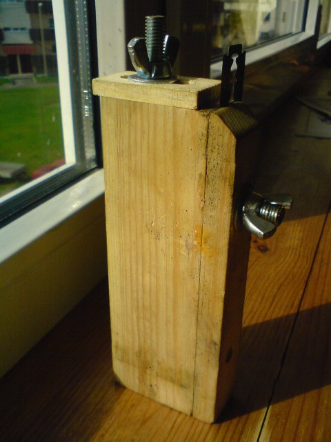

HEY GUYS...onthe leather tools forum there is a post by trastu shows a homemade string cutter...im going to try making one looks simple enough to build...has pix of it taken apart showing all the pieces looks like it would be easy enough to use it to bevel with as well. take a look.

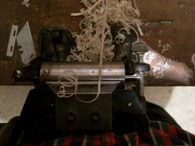

I think I have posted this before, I am sorry if this is repetitive. I had this made at a local welding shop. It is made from a solid piece of hydralic ram. It is nothing fancy, and there are a few changes that I am going to have made to it some day. But it works well for cutting rawhide and roo. I paid $50. If a guy was handy enough you could make one out of hardwood that would work I would think. Let me know if you need more info, dimensions, better pictures... etc. Would be happy to help.

I was asked for some more info on my string cutter, so here it is.
There are a few things that I am going to change when I get a chance:
The collar needs to be off set or a finger added so that the string is not against anything after it has passed the cutting edge. I have troubles some times when the strings are thick and a bit to dry wedging in and either breaking the blades off or busting the string. ( which I would rather have happen when cutting string than when braiding)
I would also like to add another angle for beveling the current one is a bit steeper than 45 and I think one closer to 30 would be nice at times.
Otherwise for the price it works great. I don't have some of the fine tuning that it looks like some of the others have but I am finding that the more I use it the better I get along with it. I have about $200 wrapped up in the splitter and cutter.
If any of this is unclear or someone would like some more info or pictures I would be more than happy to help. Please do not hesitate to ask.
Rob

Rob this is great. Thanks for posting.
I do have one follow up question/request. Dimensions? Not that I want to completely duplicate your design, The pictures just don't have much in relative size to judge with.
Thanks so much for sharing this info.
You're a gentleman and a scholar.
Marlon
Yeah sorry about the dimensions. It is 5.5 inches long by 1.5 inches in diameter. I like the diameter but having it be a few inches longer would be nice.
Rob
Thought these might help someone understand a little better.
Rob

my first cutter was very simple and took 2 hours to make. Another one was made by an welder for me, paied 40$ for this.

I made one like that some time back and it works great. The wooden one. Your design is alot better than the one I made. It adjusts out farther to cut wider strips. Thank you for sharing.

Trastu,
¿La mirada a la foto original del cortador (en el comentario 9)- ve los huecos grandes? Esto es realmente 3 pedazos, con un cerrojo que lo mantiene unido. El pequeño espacio entre los pedazos, un vertical y otro en un ángulo, es donde el cuchillo es insertada. Es sostenido en el lugar por la presión de la tuerca de mariposa en el cerrojo de asamblea. El anillo es movido hacia o lejos de el cuchillo para controlar la anchura. El anillo también puede ser colocado cerca de la ranura angulada para biselar el cordón.
Al menos esto es como lo veo trabajar.
(Online translation, y'all....I ain't that good!)
Trastu,
Look at the original pic of the cutter (in post # 9) - see the big gaps? It's actually 3 pieces, with a bolt holding it together. The little space between the pieces, one vertical and the other at an angle, is where the blade is inserted. It is held in place by pressure from the wing nut on the assembly bolt. The collar is moved towards or away from the blade to control width. The collar can also be placed close to the angled slot to bevel the lace.
At least that's how I see it working.

thank you very much for the explanation. health
Twin Oaks thank you as well.

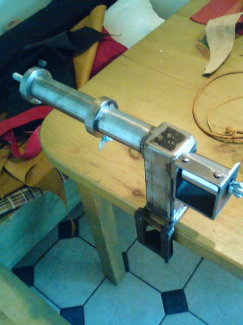

This is my favorite cutter Wayne Jueschke out of Elko made it but I'm not sure if he make this one any more ,the collars are adjusted by turning the knob on the back, that way I can make very fine adjustments. If you are going to be making alot of rawhide string I would advise having a good splitter also. this is the splitter I use the most, it uses razors ,when one gets dull you can just pop another one in it, Monte Severe made it along time ago and but doesn't make them anymore but there are many out there to choose from that are nearly the same.
