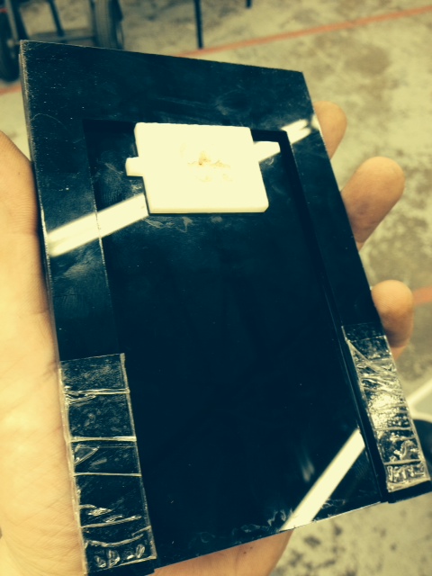

Chrome stamps just fine on a 2 ton arbor press. I'm attaching some test marks made on several Horween Chromexcel tannages.
I laser cut my marks and make jigs with alignment tabs so the placement is perfect and, as importantly, the stamp is held perfectly square to the grain so the impression is uniform. Super quick and easy. See attached.
Somewhat unrelated: some people drill their arbor presses so they can more permanently attach their marks. I use several on each piece, so this is the most effective solution. Your mileage may vary, and I know not everyone has access to a laser cutter.
