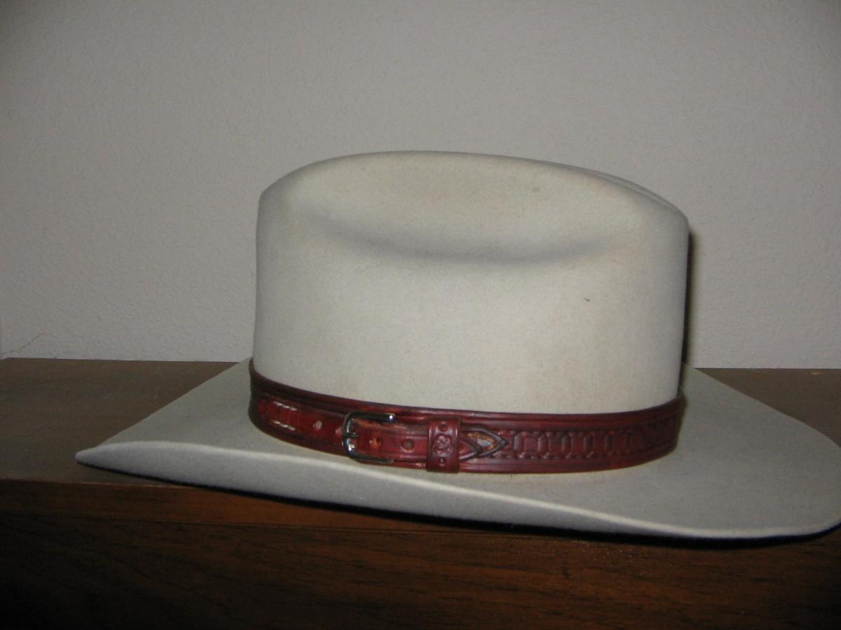

Members camano ridge Posted June 23, 2013 Members Report Posted June 23, 2013 I make my hat bands like a ranger belt size the biller and chape for the buckle set you want to use make your hat band as wide as you want. Attached is an example. Quote https://www.facebook.com/CamanoRidgeCustomLeather?fref=ts

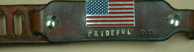

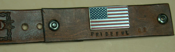

Members Desert Moon Posted June 27, 2013 Author Members Report Posted June 27, 2013 ok guys here are some picture of what I came up with, thanks for all the ideas. Made 3 style for customer to choose from. 2 in the pucture and one with a buckle. Quote
