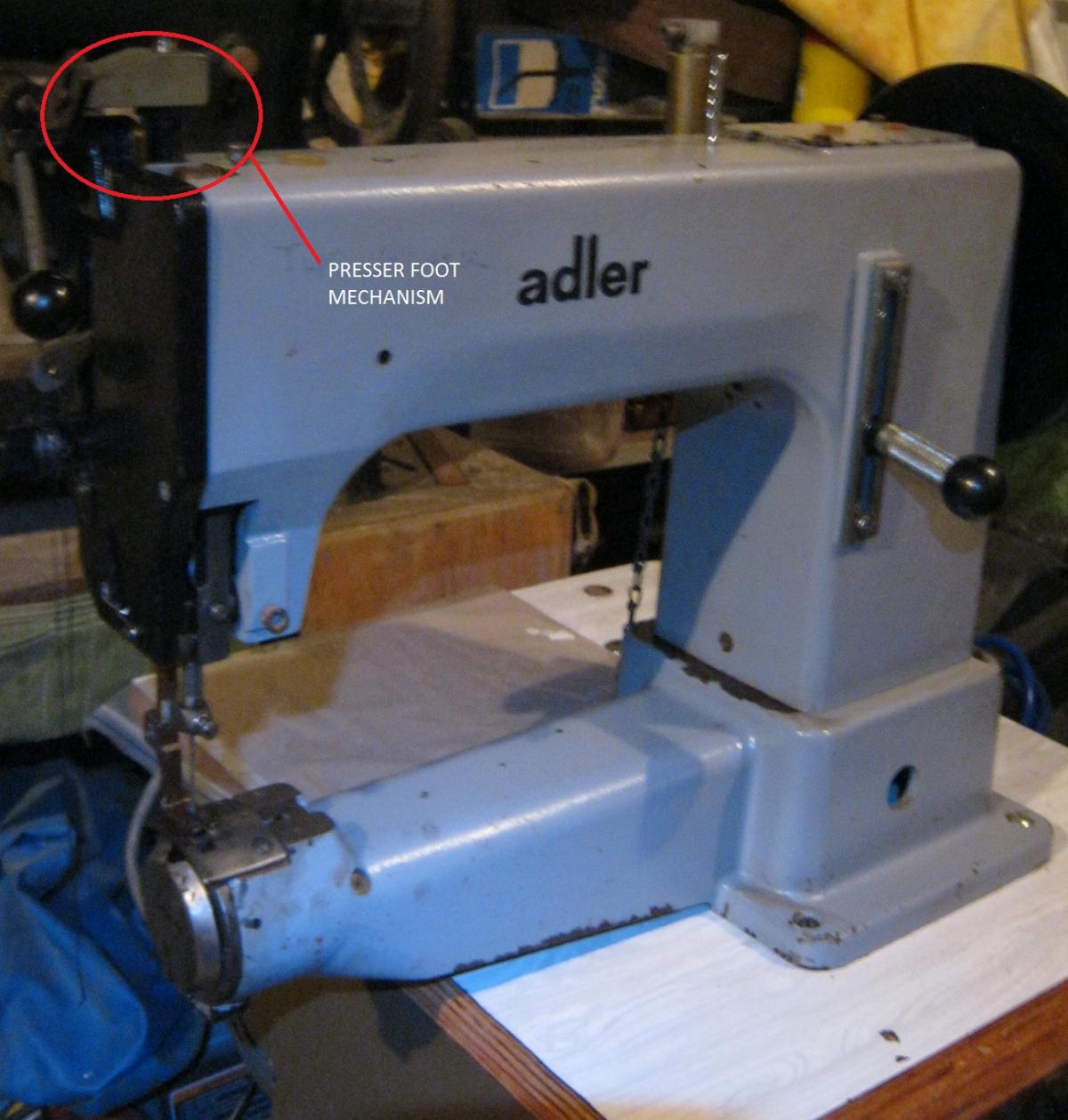

Members gordond Posted November 24, 2013 Members Report Posted November 24, 2013 I picked up a Adler 205-64 in a job lot recently. It was jammed stuck solid- I would have placed $ on betting that something was broken inside the machine. I just happened to have some triflow ,removed access panels and dosed the parts inside.but ATF/acetone ,Kroil, and the other brews all work [ATF & brews are much cheaper though] Initially nothing -- then realised the sticking part was the presser foot height mechanism [fine threads rusted solid]..this cleaned up and a redose and away it went. as you said, it will take a bit of feel ,wiggling and listening to where the issue is. Quote

Members cdthayer Posted November 24, 2013 Author Members Report Posted November 24, 2013 I picked up a Adler 205-64 in a job lot ....jammed stuck solid.....the sticking part was the presser foot height mechanism [fine threads rusted solid].... Thanks Gordon, I'll watch for that. .... plastic oil injection ports leading to all the bearings and contact surfaces.....give the ports a squirt. ....replace all bearings as once siezed, they will never run right again and cause vibration through all the shafts. Paul. Thanks Paul. This is the first one of these machines that I've tried bring back from the dead. I know I'm going to get educated once I get into it. I haven't started on it yet. I've still got a Singer 111G156 waiting for a part on my bench. I'd like to get that one going before I tackle the Adler. I'm going to have to come up with a larger drip pan to set it in before I start too. I doubt that shaft vibration will bother me much if I hand crank it, but I hadn't thought about that possibility for future powered operation, so thanks for the information. CD in Oklahoma Quote "I sew, I sew, so it's off to work I go....." My sewing machines:Adler 205-370 (Hand Crank), Adler 205-64 (Hand Crank), Consew 226 (Clutch/Speed Reducer), Singer 111G156 (Hand Crank or Clutch), Singer 111W153 (Clutch), Singer 20U33 (Clutch), Singer 78-3 Needlefeed (Treadle), Singer 20U (Treadle), Singer 29K70 (x2) (Both Treadle/Hand Crank), Singer 96-40 w/Darning Foot (Treadle), Singer 31-15 w/Roller Foot (Treadle), Singer 31-15 (Hand Crank), Singer 16-41 (Treadle), Singer 66-1 (Treadle/Hand Crank), Singer 201K4 (Treadle/Hand Crank), Singer 216G Zigzag (Treadle/Hand Crank), Singer 319W (Treadle)
