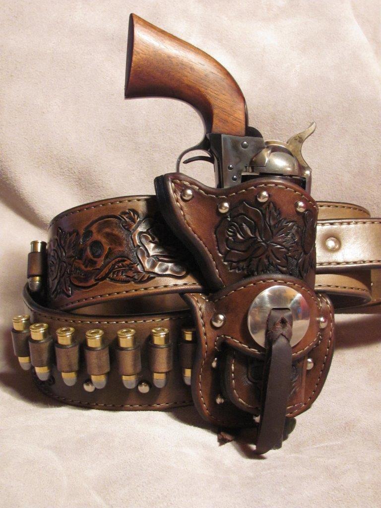

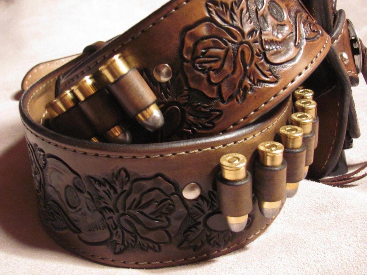

Members Josh Ashman Posted February 14, 2014 Members Report Posted February 14, 2014 It's what they wanted so I gave it my best shot. 8 oz with a 4 oz liner on the main belt and billet, 8 oz for the buckle chape, 4 oz on the loops and 8 oz with a 6 oz liner for the hoster, all HO. Finished with a coat of NF oil then Fiebings liquid acrylic antique washed off pretty heavily, a light coat of M&G cut 50/50 with water and then wiped down with glycerin saddle soap to make it feel and smell like gunleather instead of a clean floor. It's built for a 3-1/2" Cimarron Thunderer but it has my 5-1/2" SAA in it for the pictures. Thanks for looking, Josh Quote

Members Haystacker Posted February 14, 2014 Members Report Posted February 14, 2014 I think you could make anything look great on a rig. I'm not into skulls and such but you sure made a great looking rig. Quote haysholsters@hotmail.com NRA Life Member
Members St8LineGunsmith Posted February 14, 2014 Members Report Posted February 14, 2014 there was the hand of God rig now there is a reaper rig not my taste but hey whatever the customer likes and you pulled it off well Quote No Matter Where Ya Go There Ya Are. Chattown Leatherheads American Plainsmen Society Society Of Remington Revolver Shooters(SCORRS) THE SUBLYME & HOLY ORDER OF THE SOOT, (SHOTS) The St8 Line Leathersmith I was Southern Born, I am Southern Bred And when I Die I will Be Southern Dead! I fly this Southern Flag Because my Ancestors Flew it in A war to ensure our God given rights against a Tyrannical Government. Heritage Not Hate!
Members Josh Ashman Posted February 14, 2014 Author Members Report Posted February 14, 2014 Thanks Haystacker and St8line. I agree with the skulls, I'm not really into them and I wouldn't be sad if they were the first and last I tried to carve, although I was happy enough with how they turned out. I do plan on using those roses again though, they weren't too bad to carve and I really liked how they turned out. Best regards, Josh Quote
Members WyomingSlick Posted February 14, 2014 Members Report Posted February 14, 2014 Hmmmm........"Flowers for the Dead" seems like an appropriate theme for a gunbelt to me. And that is a crackerjack job of it ! Quote (John 8:32) And ye shall know the truth, and the truth shall make you free. (KJV) And the truth is that religion is nothing more than the lame attempt by largely ignorant people to bring sense and order to a world that was beyond their comprehension. Once you see religion for the delusional and superstitious artifact it is............... you will be free !
