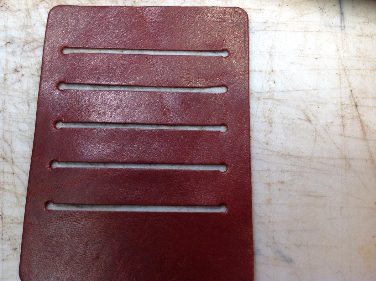

Contributing Member Bob Blea Posted July 31, 2014 Contributing Member Report Posted July 31, 2014 Here's the thread Stephenpuhakish was thinking of: http://leatherworker.net/forum/index.php?showtopic=56473 About 2/3 down the page electrathon posted the die he made using razor blades. It's pretty cool! Quote There are always possibilities.... Bob Blea C and B Leathercrafts Fort Collins, CO Visit my shop at http://www.etsy.com/shop/CandBLeather?ref=si_shop Instagram @bobbleacandbleather
Members Stephenpuhakish Posted August 1, 2014 Members Report Posted August 1, 2014 http://www.ebay.com/itm/311024933438 Managed to find a few, getting just the right combination of search terms was key "Wallet card punch" will pull up at least a half dozen if not more. And thanks Bob, I really am search tool handicapped. And it seems electrathon used acrylic or plastic rather than wood, but the idea is there Quote
electrathon Posted August 1, 2014 Report Posted August 1, 2014 Here is the slot cutter I made. The main advantage is that every slot is perfectly straight to the other slots. Quote
