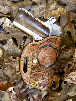

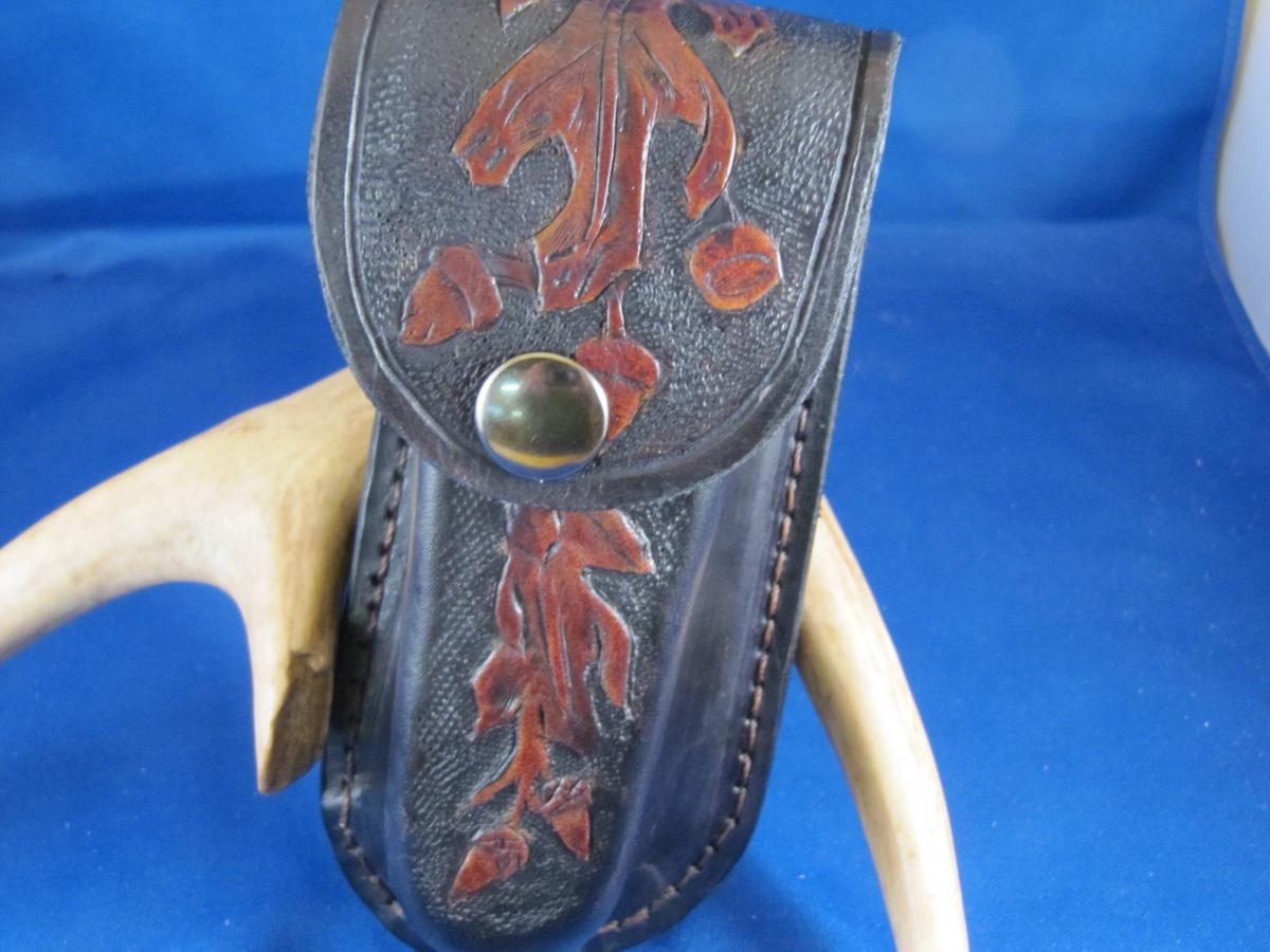

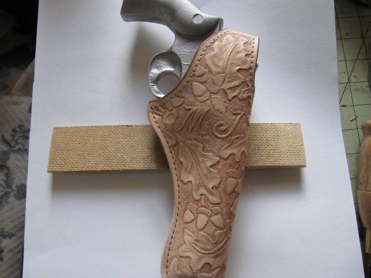

Members camano ridge Posted August 16, 2014 Members Report Posted August 16, 2014 (edited) I think the easiest way to be able to answer your questions is if you post a picture or drawing of approximately what you want to make. I don't totaly agree that you can't mold and tool. I do agree that you can not detail mold without wiping out the tooling in the areas being detail molded. There are ways to acomplish tooling on shaped item to an extent. If your shot shell carrier is boxy you can gouge grooves where you will do the folds. Do your tooling between the folds, wet the gouged lines and fold to form your box. Your tooling is unharmed. I just did a case for a folder. I wet molded the front of the case around a form. I kept the piece on the form and let dry to almost natural color (pretty much casing the leather. The form supported the leather and I tooled the case using the form as backing. You can find many examles of tooled holsters that have been shaped around a gun. I have attached some examples. ALso look at theEpi pen cases on plinkercases.ca (he is a member on these forums). The epi pen cases are tooled and formed around epi pens. The first picture is of a tooled holster I am currently working on. (I know I have the decorative cuts on the acorn going the wrong way). HTe second picture I don't remember who did it so I can't give them proper credit for the excelent job they did. It makes a great example. Edited August 16, 2014 by camano ridge Quote
