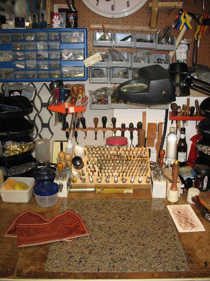

Members rgerbitz Posted October 29, 2008 Members Report Posted October 29, 2008 A friend brought this by today, she got it from a kitchen installer, free or charge. I am thinking that I would like to set it into my work bench but would need to square it up a bit first. Anyone have any ideas on how, or what to use to cut this with. It is roughly 2.5 by 1.5 feet. Thank you Rob Quote http://gerbitzquarterhorses.com/

ArtS Posted October 30, 2008 Report Posted October 30, 2008 (edited) I got a piece from a friend that just redid his counter tops. I also borrowed a diamond (dry) circular saw blade from another coworker to cut it with. Ii cut through as easy as cutting a piece of wood. Tape where you cut so that it won't chip and go slow. I used my router to cut a section out of my workbench to place it in so that it would be even with the bench top. I used silicon around the edges so there would be no gaps. Art Edited October 30, 2008 by ArtS Quote Art Schwab "You cannot teach a man anything. You can only help him discover it within himself." – Galileo Galilei
