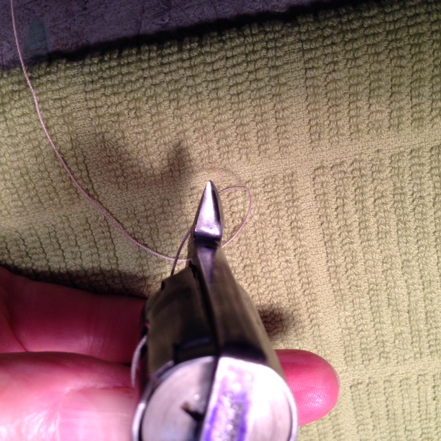

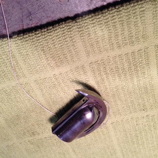

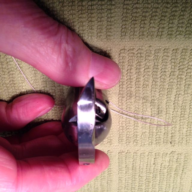

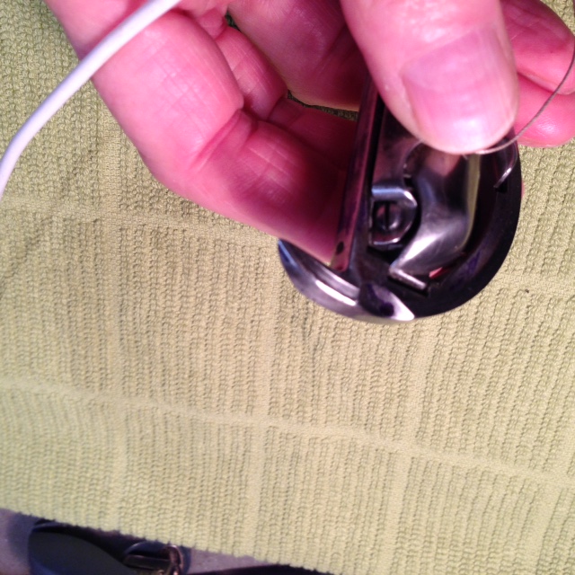

Evo160K Posted December 3, 2014 Author Report Posted December 3, 2014 Thank you Constabulary, Jimi. It was somewhat of a shock to see that ring of "glue" in there! Here's a phenomenally well engineered and constructed piece of fine machinery from the 1940's with beautifully machined fasteners, and a piece is held with "glue?" I couldn't accept it. Thanks for setting my anxiety to rest. Jimi, what type and size of thread is in the bobbin in your picture above? Thanks again to you both. Quote
