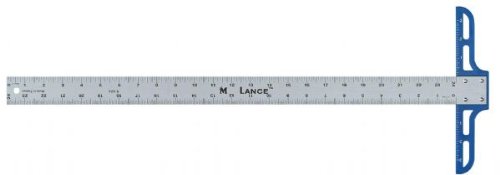

Members DavidL Posted November 20, 2014 Members Report Posted November 20, 2014 In woodworking there are combination squares that mark a perfect 90 degree line and I want to know if there are commercially made items are made for leather. My idea is to make one of those rulers and have it pushed up against the table so that way you can push a piece of leather with a straight edge into it to mark up a 90 degree line. The ruler will be mounted onto the table so it doesn't move and can move down or up to fit different thicknesses. Has anyone here tried to do something like this. It seems like It would work and would like your thoughts on it. Quote
Members billybopp Posted November 20, 2014 Members Report Posted November 20, 2014 I have two of the squares you have pictured. One is 12", the other 24". I frequently use them in conjunction with my marble slap and / self-healing mat. They aren't mounted, but they work great. I also have a larger carpenter's square that I use when cutting big pieces of leather. ... And an assortment of rubber or cork backed metal rulers from 6" to 60". I also have a General tools ultra-rule square that I really love for marking things with the scratch awl, but they appear to be no longer made. Bill Quote
Chief31794 Posted November 20, 2014 Report Posted November 20, 2014 (edited) I use T-sqares a lot, but when I want excellent accuracy I use a clear acrylic quilting square, friskars makes good ones, I have several of different sizes. They work great. The problem I have with T-sqares and Tri-Squares, etc, is that they only work well if the edge you are putting it against is perfectly straight. Leather, even when cut very carefully might not be exactly straight. I use the T-sqares to line up borders across straps, etc. Chief Edited November 20, 2014 by Chief31794 Quote "Life's too short to carry ugly leather"
Members Hi Im Joe Posted November 20, 2014 Members Report Posted November 20, 2014 I use T-sqares a lot, but when I want excellent accuracy I use a clear acrylic quilting square, friskars makes good ones, I have several of different sizes. They work great. The problem I have with T-sqares and Tri-Squares, etc, is that they only work well if the edge you are putting it against is perfectly straight. Leather, even when cut very carefully might not be exactly straight. I use the T-sqares to line up borders across straps, etc. Chief I second the quilting square. One of the best things I have ever bought for leatherwork. Quote http://www.sevenhillsleather.com/
Members DavidL Posted November 20, 2014 Author Members Report Posted November 20, 2014 quilting squares are they for marking or are there openings so you can cut? I been having trouble with getting completely squared boxes. It usually ends up square. 1 out of 10 times it will be off by a fraction of a mm, its not much but if its not a square it bothers me a bit. It is also a huge time waster to draw 2 sides using a 90 degree ruler and then have to line up the ruler to cut -- very difficult to get the ruler to fall exactly on the line made by a scratch mark with a pen mark its nearly impossible for me. Do you guys have any tips? I been thinking about getting a solid metal sheet, very thin. Get that sheet and rest it in the tiny groove that the scratch awl makes and push a ruler against it and it will be exactly on that line Or the modified wood working square mounted to the edge of a table and then I could use an awl placed on the line to push the straight edge against. Quote

Chief31794 Posted November 20, 2014 Report Posted November 20, 2014 quilting squares are they for marking or are there openings so you can cut? I been having trouble with getting completely squared boxes. It usually ends up square. 1 out of 10 times it will be off by a fraction of a mm, its not much but if its not a square it bothers me a bit. It is also a huge time waster to draw 2 sides using a 90 degree ruler and then have to line up the ruler to cut -- very difficult to get the ruler to fall exactly on the line made by a scratch mark with a pen mark its nearly impossible for me. Do you guys have any tips? I been thinking about getting a solid metal sheet, very thin. Get that sheet and rest it in the tiny groove that the scratch awl makes and push a ruler against it and it will be exactly on that line Or the modified wood working square mounted to the edge of a table and then I could use an awl placed on the line to push the straight edge against. You put the lines on the square on the line so that the edge of the square is where you want to cut, then you can use a rotary cutter or any kind of knife to cut along the edge. I have them in 12.5" X 12.5", 8.5" X 8.5" and 6.5" X 6.5" the cover just about every thing. Chief Quote "Life's too short to carry ugly leather"
