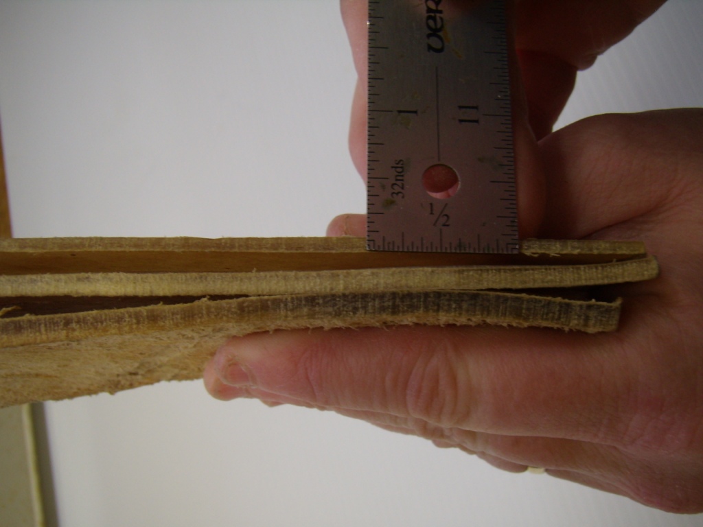

Members raftert Posted November 6, 2008 Members Report Posted November 6, 2008 How are yall, A customer just ordered a saddle with these spects. 15" SF Bowman double dally horn 2" cap, 93 degree, fiberglass on the wood then double bullhide cover. First question, will I have to order a 15 1/2" or 16" tree so when all this material is placed on the wood the finished tree will be a true 15" and in all of your opinions is this overkill in rawhide and not worth the extra cost. This man trips alot and is very hard on a saddle. He has broken several trees from pretty well known saddle makers. Tim Quote
Moderator bruce johnson Posted November 6, 2008 Moderator Report Posted November 6, 2008 Tim, As far as is the extra cost worth it? That extra expense will be the cheapest part of that saddle. Your time to take out and stick a new tree in to replace one that is broken is way more. If you and the tree maker do eveything he wants, then if it breaks - it just plain broke from use and no excuses. Some tree makers used to put a steel "skid plate" in the gullet and bolt the horns on rather than screws too. I am not sure if anyone does that anymore. Regarding what size to order, I'd talk with the treemaker and see how much they think the extra will take in. They should have a pretty good idea. It sure could be 3/4-1" figuring doubling up on the back of the swells and depending on if you measure the cantle at the peak or the front of the face. Quote Bruce Johnson Malachi 4:2 "the windshield's bigger than the mirror, somewhere west of Laramie" - Dave Stamey Vintage Refurbished And Selected New Leather Tools For Sale - www.brucejohnsonleather.com

Members kseidel Posted November 6, 2008 Members Report Posted November 6, 2008 How are yall,A customer just ordered a saddle with these spects. 15" SF Bowman double dally horn 2" cap, 93 degree, fiberglass on the wood then double bullhide cover. First question, will I have to order a 15 1/2" or 16" tree so when all this material is placed on the wood the finished tree will be a true 15" and in all of your opinions is this overkill in rawhide and not worth the extra cost. This man trips alot and is very hard on a saddle. He has broken several trees from pretty well known saddle makers. Tim Tim, It is your treemakers responsibility to deliver a tree finished to your specs. He will need to adjust for extra thickness in seat length as well as gullet height and width, space between bars, cantle height, horn cap width, etc, etc. That is a lot of insurance, but as Bruce said, replacing a tree is very costly, and rarely fits as well as the original. Depending on who you chose as treemaker, there are other considerations in tree construction to make it stronger. Better wood, laminated bars, dovetailed attachment of front and cantle.... not all treemakers make the same quality of trees. I used to have to replace quite a few broken trees prior to switching to better made handbuilt trees. I have not had to replace one in over 15 years. I do not mean to impune factory made trees, but the construction methods used to facilitate volume do not allow for some of the features in handbuilt trees that make them stronger. Keith Quote Keith Seidel Seidel's Saddlery www.seidelsaddlery.com
