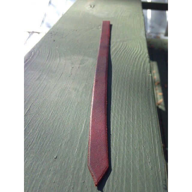

jpowell1989 Report post Posted December 4, 2014 Bought the Tan leather dye by Fiebing's but it looks way darker than it should. I'm ok with the color but was expecting something lighter. Do I need to continue to buff the hell out of it? Or did I apply too much dye? Quote Share this post Link to post Share on other sites
electrathon Report post Posted December 4, 2014 dilute it with alcohol Quote Share this post Link to post Share on other sites
jpowell1989 Report post Posted December 4, 2014 should i apply it straight to the leather with a cloth? Quote Share this post Link to post Share on other sites
electrathon Report post Posted December 4, 2014 I either dip dye things or apply the dye with a piece of sheepskin. I almost always need to dilute it or it will be way dark. Wear gloves. Quote Share this post Link to post Share on other sites
jpowell1989 Report post Posted December 4, 2014 ok i'll give alcohol a try. I'm just hoping it will not make it splotchy. Quote Share this post Link to post Share on other sites
whipstitchwallets Report post Posted December 4, 2014 I use fiebing's tan dye non-diluted all the time, and even after I apply mink oil it isn't that dark. I dip dye and wipe off the excess. Has that item dried for 24 hours? Quote Share this post Link to post Share on other sites
jpowell1989 Report post Posted December 4, 2014 it has not. Quote Share this post Link to post Share on other sites
Chief31794 Report post Posted December 4, 2014 I dilute all feibings dyes at least 1:1 some even more except Pro Oil Black, that I leave undiluted. I have cut Medium Brown 10:1 with the 10 being the alcohol, but that was for a particular look. Most of them work and look really nice at 1:1 or 2:1 and it makes the dye more economical. I think that diluting them at least 1:1 makes them penetrate the leather better, but I have no scientific proof of that. Chief Quote Share this post Link to post Share on other sites
snubbyfan Report post Posted December 5, 2014 Give it some time to dry, it should lighten up a bit with time. The holsters were dyed straight from the bottle and the sheath was diluted. These two holster were dyed from the same bottle of saddle tan. They're made from two different hunks of leather. Quote Share this post Link to post Share on other sites
Jaymack Report post Posted December 5, 2014 I dilute Fiebings tan dye 2:1, and 4:1 when I'm applying antique on top of it. Quote Share this post Link to post Share on other sites
