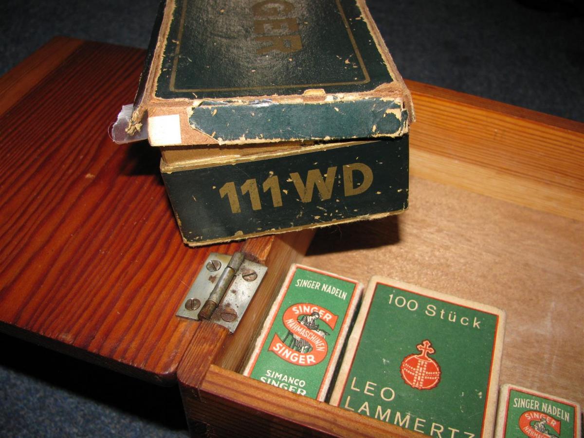

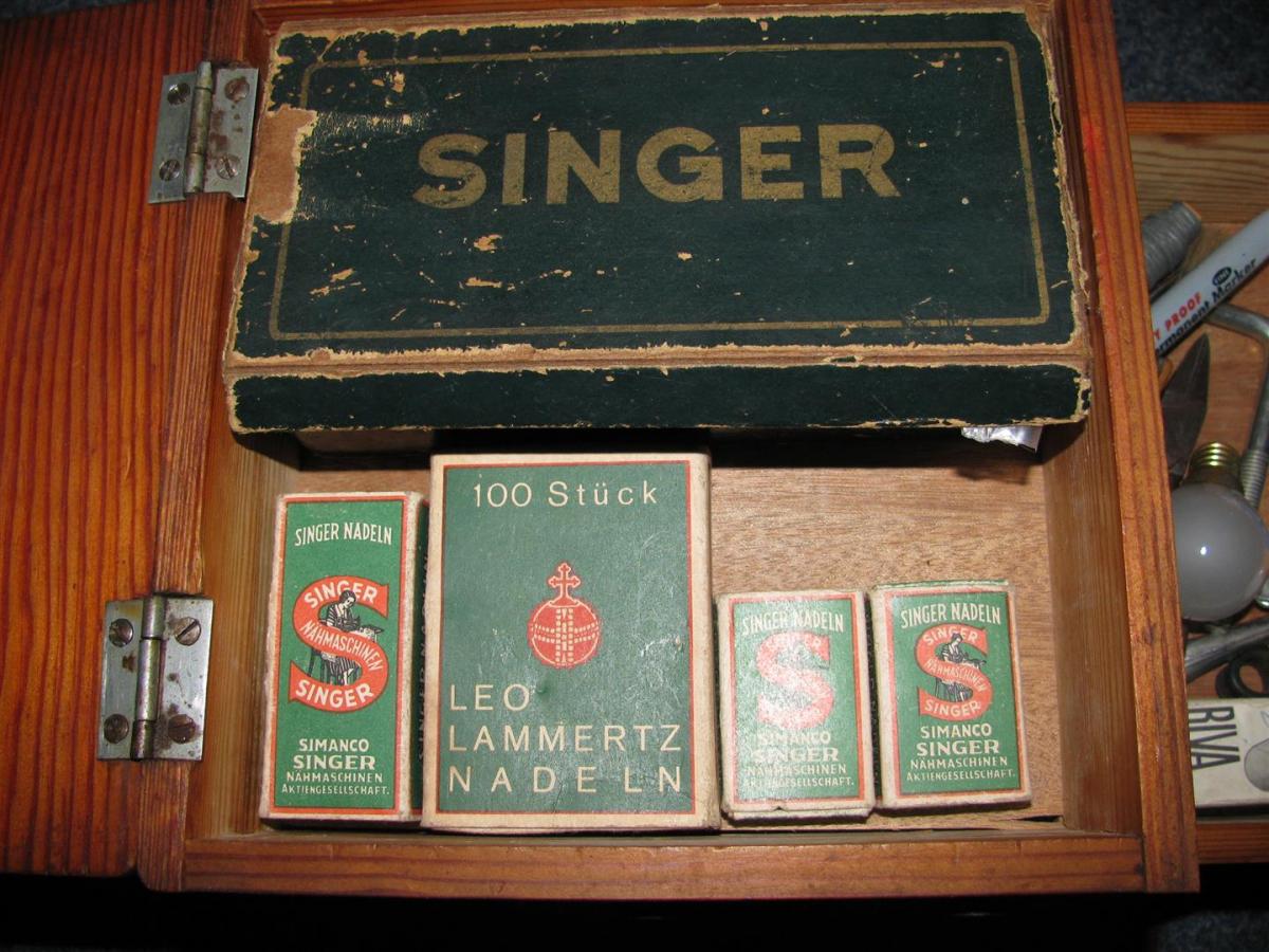

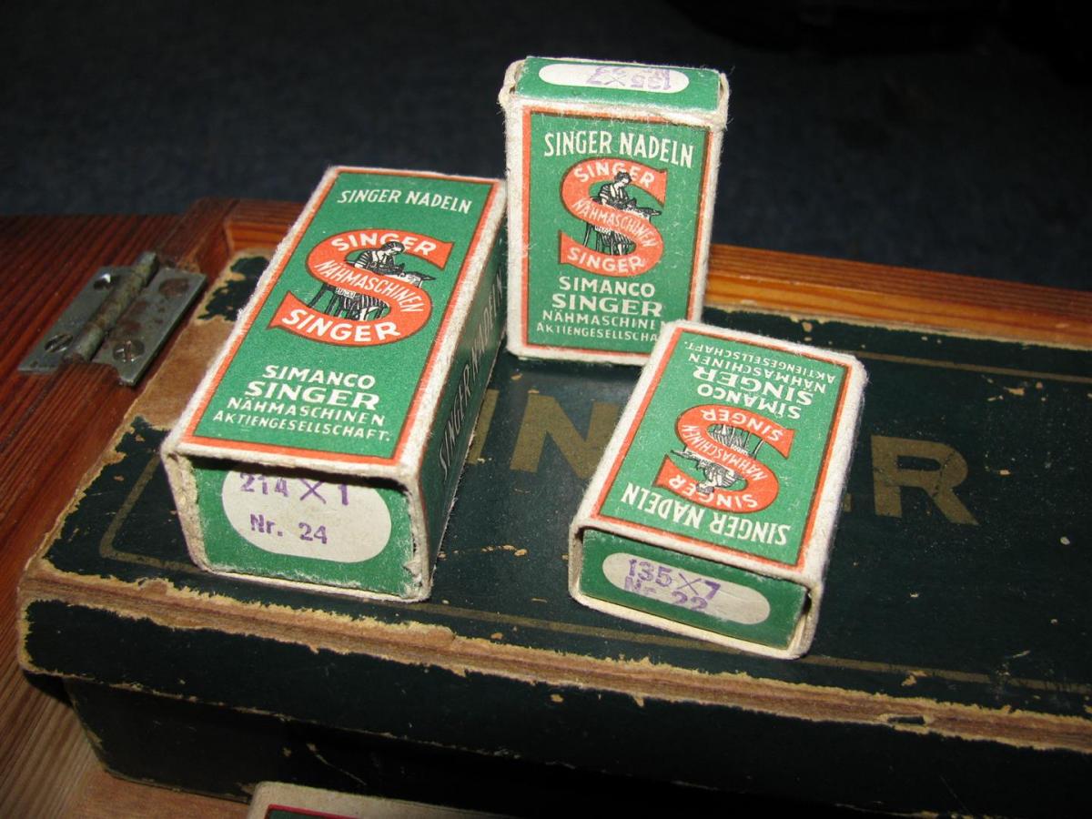

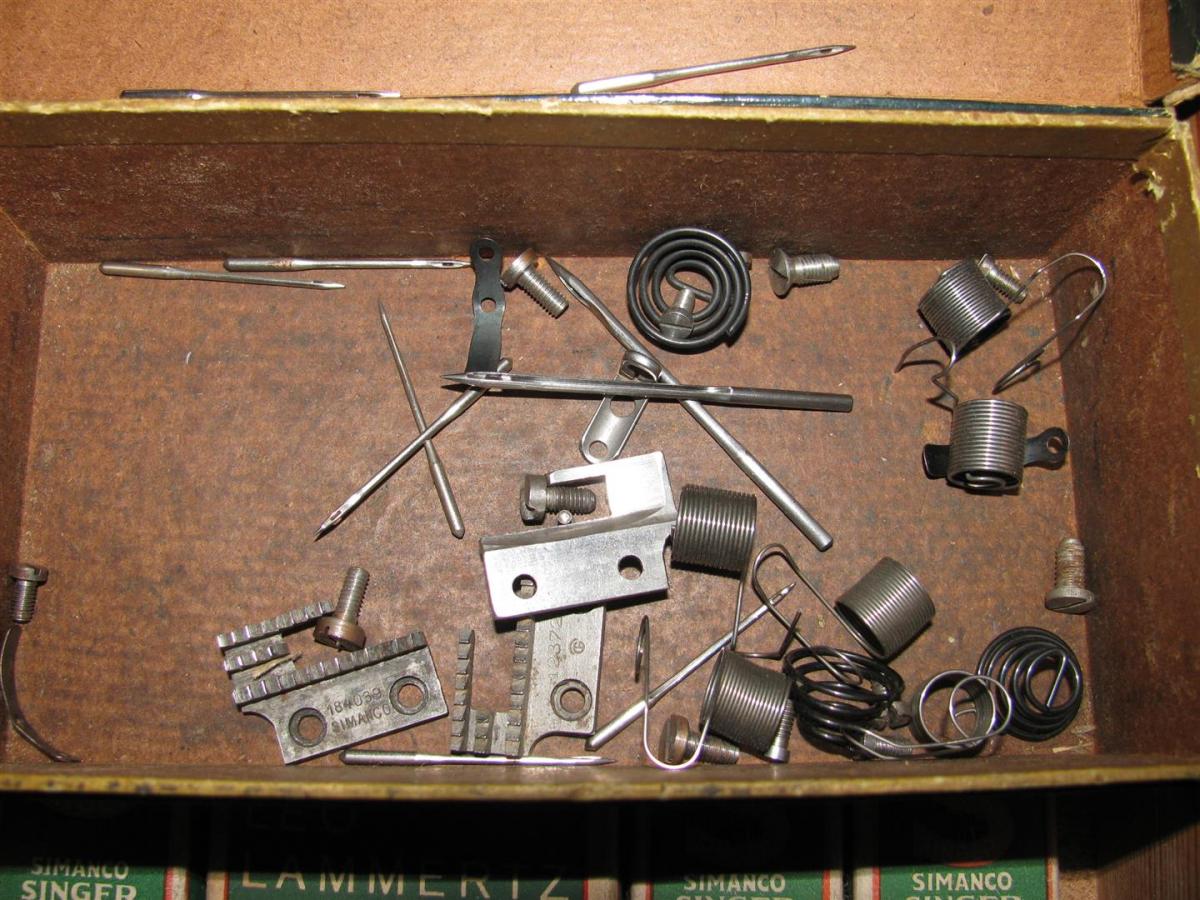

alexitbe Posted December 19, 2014 Author Report Posted December 19, 2014 Just a quick update: I bought it. I have just brought it home tonight via the train. Hae given it a quick spray with Wd40, before doing a real clean in the next few days. I also have something much better, which I have just recieved from our good friend Constab. I don't know why Wizcraft suggested that particular model but I think he is correct. It is the large bobbin and from my Singer 29k71,72,73 service manual the bobbin and shuttle is the same as the 72 and not the other two. The bobbin is threaded differently to the other two also.. Very good guess. Another thing, thanks to Constab, I checked the stitch length and was a little surprised. In contrast to his it decreases as you go up and it starts at 4.5 and finishes at 2. The stitches follow this too, mybe not in absolute size but in icnreasing and decreasing. So I think this machine is a quite light weight patcher, mainly from the maximum short stitch length. I will place pictures up over the next few days. I will slowly clean it properly, but in a peace-meal fashion. It came with really old looking needles by lammertz. The 88L system size 3 and 6. I don't know what any of that means yet. I will post a picture of the paper packet they came in as it is terribly old fashioned. Almost Edwardian... Cheers Alex Quote
Moderator Wizcrafts Posted December 19, 2014 Moderator Report Posted December 19, 2014 Once you clean and lube it, then replace any badly worn parts, you are going to love the machine. Just remember that it is a patcher, not a production machine and not a holster machine either. The correct needle systems are 29x4 or 135x16. The original design of the 29x4 is no longer made. Now, everybody has switched to 135x16 needles. Also, don't break it by using thick thread. Stay with T90 or T70. Needle sizes 100, 110 and 120 and 125 should handle those thread sizes just fine. Quote Posted IMHO, by Wiz My current crop of sewing machines: Cowboy CB4500, Singer 107w3, Singer 139w109, Singer 168G101, Singer 29k71, Singer 31-15, Singer 111w103, Singer 211G156, Adler 30-7 on power stand, Fortuna power skiver and a Pfaff 4 thread 2 needle serger.
