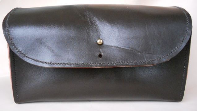

thefanninator Report post Posted February 22, 2015 I went ahead and put a Sam Browne stud closure on mine, took some lousy photos and the whole thing is just mush. It doesn't hold it's shape and is hard to close. I'm currently unstitching it and will line it to stiffen it a up a little more. Hope I don't waste the goatskin lining. Lined it with goatskin, added a pocket. Hope to stitch it all back together tomorrow. Quote Share this post Link to post Share on other sites

thefanninator Report post Posted February 22, 2015 Well that's a bummer. Sometimes you can clean up some of the glue but you never can uncut leather. I'll save all of you some trouble and tell you my tale. I decided to stitch this project inside out which worked fine but the leather was, as I said too thin to hold it's shape. I took it apart and added a goatskin liner. Well of course the pricking marks were covered up by the goatskin except on the finished side but because I originally stitched it inside out the marks were backwards. Anyway after trying several different configurations - what was best was to turn the folds out, glue goatskin to goatskin and stitch it normal. I'm not sure what you call the gusset style of the original pattern - the way they fold in but I did it opposite. It's almost ready to photograph, which is something else I need to work on. Quote Share this post Link to post Share on other sites

thefanninator Report post Posted February 24, 2015 (edited) Mine is about as done as it's going to get. I plan on painting the edges but don't have dark brown right now. Overall I'm pretty satisfied but have a few sore spots. I used Spanish Glass calfskin in espresso 2.5/3 oz lined with terra cotta Sokoto goatskin (both the same as my vertical wallet). I used chocolate Crawford linen thread from Royalwood. I think my stitching would have turned out better had I used my smaller Fil au Chinois Lin Cable. I decided on a Tom Browne stud closure which, with this thin calfskin, was a bad decision. I also punched two closure holes and regretted the second almost immediately but it does close a little tighter. I'm glad I went back and lined it and added an interior pocket which I have never done. I stitched the pocket to the liner then glued it in and trimmed the excess. Edited February 24, 2015 by thefanninator Quote Share this post Link to post Share on other sites
MonicaJacobson Report post Posted February 24, 2015 The folded pocket edge looks really nice. In fact, the overall effect is very slick. If you were selling it, I think you'd have the same permanent closure problem mine has. It'd need something extra to keep it closed, probably. One thing. I'm not 100% about this, but I think the smaller the thread and thinner the material, the closer to the edge you stitch. Quote Share this post Link to post Share on other sites
thefanninator Report post Posted February 24, 2015 (edited) The folded pocket edge looks really nice. In fact, the overall effect is very slick. If you were selling it, I think you'd have the same permanent closure problem mine has. It'd need something extra to keep it closed, probably. One thing. I'm not 100% about this, but I think the smaller the thread and thinner the material, the closer to the edge you stitch. Thanks, on the pocket. Yep, on the closure. Yep, on the stitching. For some reason I can't see anyone buying it so I'll probably unstitch it again, trim it and make it smaller or a clutch. Edited February 25, 2015 by thefanninator Quote Share this post Link to post Share on other sites
cardinal leather Report post Posted February 25, 2015 i like the leather you built this project out of, very nice. What could be better than a comb pocket in a ditty bag. The closure will work out as it gives extra space in case you get it a little full. nice job chris. Quote Share this post Link to post Share on other sites
thefanninator Report post Posted February 25, 2015 (edited) Thanks Cardinal! I'm really glad I did the pocket and folded the edge. Edited February 25, 2015 by thefanninator Quote Share this post Link to post Share on other sites
