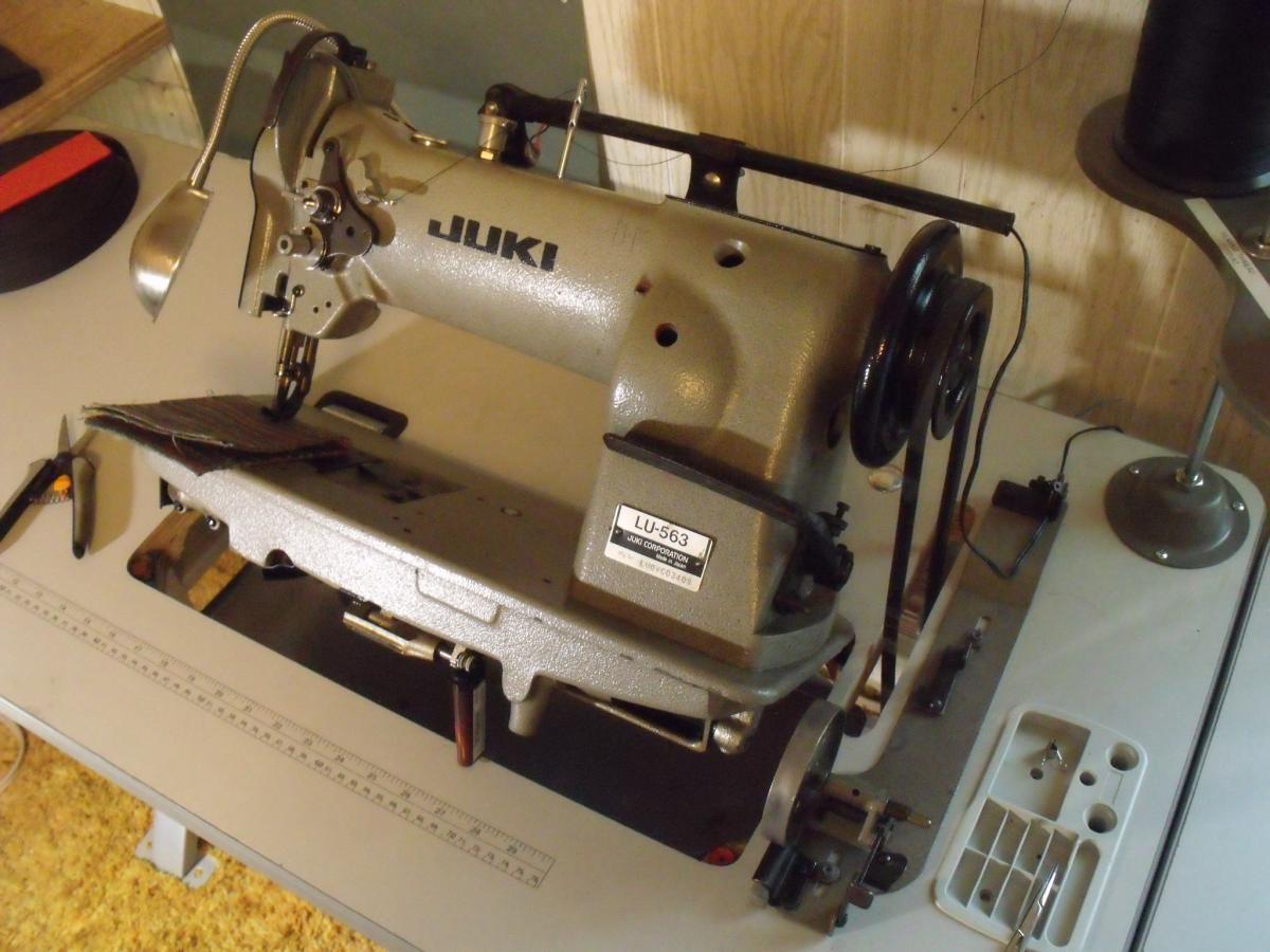

Wizcrafts Report post Posted February 23, 2015 I have one machine that is powered directly by a FS-550 and another with a FS-550 going to a 3:1 speed reducer, then up to the machine. Both motors are fitted with 50mm pulleys and are unmodified. The direct powered machine has a maintainable slowest running speed of about 1.5 stitches per second. But, it is trivial for us to do single stitches and stop needle up or down. The other machine, with the reducer, can actually be kept at the blazing pace of one stitch in 10 to 12 seconds (it has a bigger flywheel pulley). The only practical use for such a slow speed is to watch exactly where the needle is going to hit, which is useful when doing repairs to previously sewn work. More useful is simply turning the speed limiter switch to the slowest setting and flooring it. This gives us a steady speed of one stitch per second. This is useful when I sew fishtails or other patterns onto belts and straps. In hindsight, I should have had a speed reducer installed on the other machine when I ordered it. Adding it on now will require repositioning the bobbin winder and possibly enlarging the belt slot in the custom cut table. Do I recommend speed reducers for leather sewers? You betcha! The ones now for sale from our member-dealers should all have ball bearings, rather than the old style sleeve bearings. If you are buying a new sewing machine and the dealer offers a speed reducer installation option, take it. You'll save yourself a lot of trouble later on. Quote Share this post Link to post Share on other sites
JoMama Report post Posted February 26, 2015 I bought a speed reducer that looks like THIS one and it was a pain to install because you cannot tilt your machine back since the drive belt is no longer in line with the machine tilt pivot and machine pulley. I suggest getting one of THESE since it will save you at least $100 worth of headache. I wish I had. You will not have to cut a bigger slot in your table either. Quote Share this post Link to post Share on other sites
Constabulary Report post Posted February 26, 2015 The speed reducer it self mostlikely is not the problem. The problem is the position of your SR. I have no problems with mine and I didn´t cut a wider or longer slot in my table. My SR is "home made" but pretty much the same "style". I only had to move the motor a bit to the back. So I would guess your setup is the problem and not the part. Quote Share this post Link to post Share on other sites
JoMama Report post Posted February 27, 2015 The speed reducer it self mostlikely is not the problem. The problem is the position of your SR. I have no problems with mine and I didn´t cut a wider or longer slot in my table. My SR is "home made" but pretty much the same "style". I only had to move the motor a bit to the back. So I would guess your setup is the problem and not the part. You guessed wrong. The problem is that the speed reducer I bought does not attach easily, when there is not enough table to move the motor back or forward. I had to make a couple spacers and move the motor down 5". If I had more table I could have moved it back 4". The speed reducer I now wish I had bought will fit any table, appears to bolt right up with no drilling needed and a lot less fidgeting with alignment, not to mention it uses sealed ball bearings instead of cheap bushings and keeps the motor over the pedal so your linkage is not at some goofy angle. Quote Share this post Link to post Share on other sites

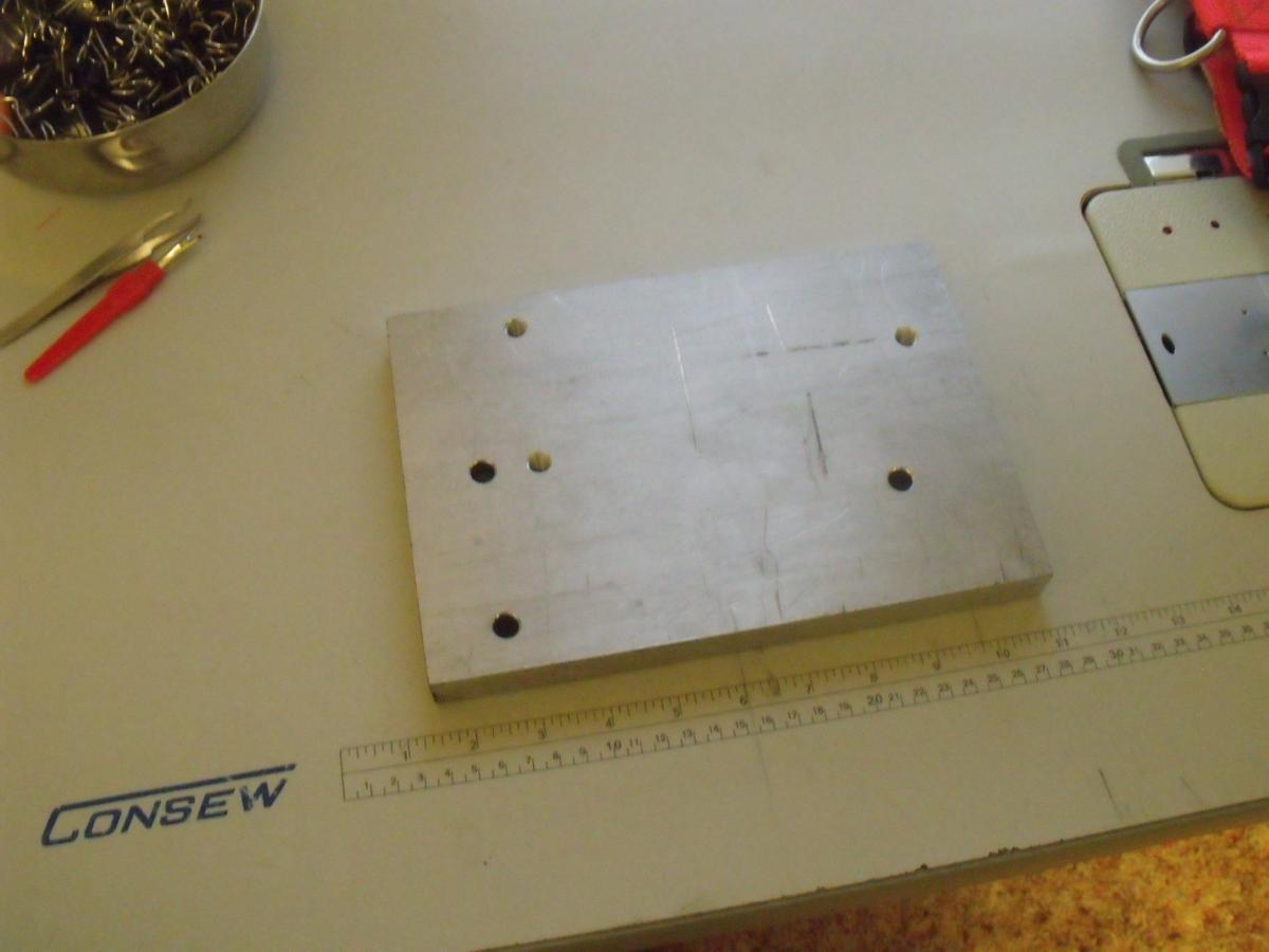

SARK9 Report post Posted February 28, 2015 (edited) I've done several clutch motor/servo swaps and with the typical narrow industrial tables, my solution has been to install an offset plate that mounts to the original carriage bolts in your table, but offsets some new mounting studs to the right side to compensate for the extra width of the reducer pulley. This arrangement also lets the motor set back far enough that the large pulley won't interfere with the motor pulley, and allows normal use of the belt cutout and the tilt-back of the machine head. -DC Edited February 28, 2015 by SARK9 Quote Share this post Link to post Share on other sites
Constabulary Report post Posted February 28, 2015 @JoMama You are right, I forgot that my table is deeper than most others. So I was a bit on the wrong track! The idea of SARK9 is good. I think you also can do that with plywood and carriage bolts for the motor. Or use drive in nuts or threaded inserts instead. Quote Share this post Link to post Share on other sites
