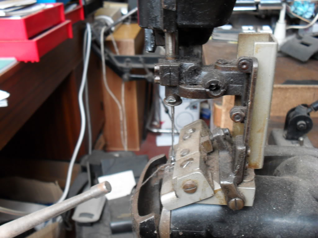

Trox Posted March 18, 2015 Report Posted March 18, 2015 Hi, I been thinking about copying this 441 attachment for box stitching. It was either Artisan or Ferdco who came with it in the first place. The principals is of course the same, you need to have a wooden lest inside to make this work too. Tor Quote Tor Workshop machines: TSC 441 clone/Efka DC1550, Dürkopp-Adler 267-373/Efka DC1600, Pfaff 345-H3/Cobra 600W, Singer 29K-72, Sandt 8 Ton clicking machine, Alpha SM skiving unit, Fortuna 620 band knife splitting machine. Old Irons: Adler 5-27, Adler 30-15, Singer 236W-100

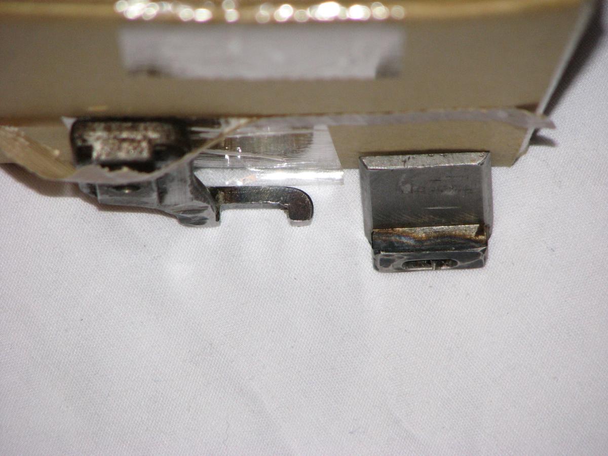

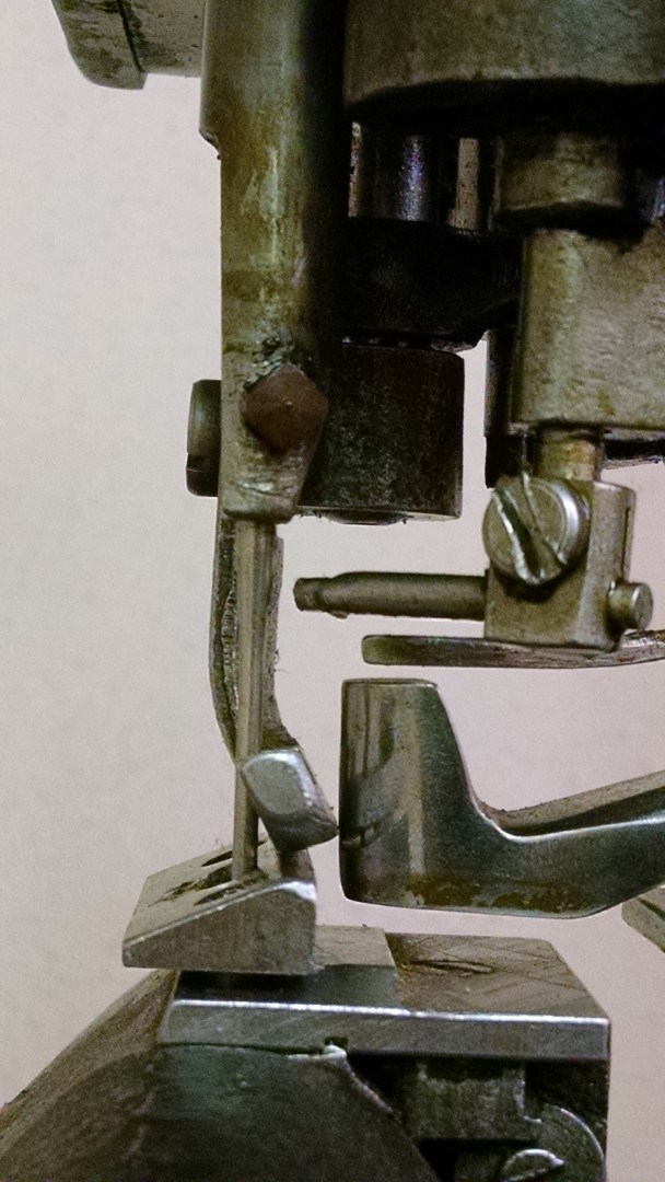

Members catskin Posted March 22, 2015 Members Report Posted March 22, 2015 I have an American straight needle machine, and looking at what this thread has to say I wonder if someone with a bit of skill and tools could make a good box stitcher attachment for them being that they are made to stitch very near the edge. Looking at the pictures on here I think it would be worth it for any one doing much box stitching. What do you experts think? Quote
