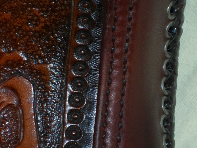

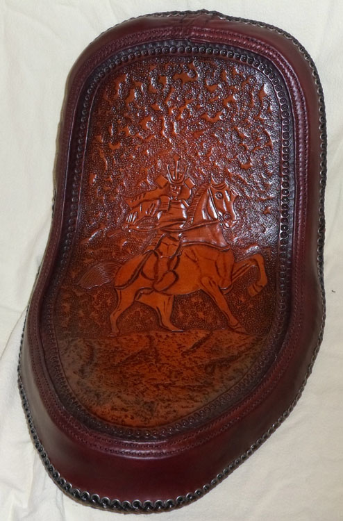

Here's the latest motorcycle seat I just finished. I posted more pics in the motorcycle gear section.
post-8346-0-92641900-1431288231_thumb.jp
post-8346-0-35907800-1431288248_thumb.jp
post-8346-0-75498900-1431288263_thumb.jp
Looks like you have a tremendous amount of hours in this one. I've never tooled, so can't be a judge, but I really like the way it came out.
YinTx
What thickness of leather do you use? How do you finish it so it can handle things like rain?
A friend of mine wants me to tool a seat for him and I've never done one so I'm curious.
Thanks
The tooled pieces on the top and bottom are 7-8 oz veg tan. The piece on the side is Nomad Oily Side from Tandy leather. First I coat everything with a few gernous coats of neetsfoot oil, some folks don't like neets foot oil because it can darken the dye but I like the richness it brings to the dye. Just my opinion. I let the oil soak in overnight. Then on the veg tan top and bottom panels I put on many coats of Kiwi neutral shoe polish. Apply, brush, buff, and repeat. I use a buffing attachement for my drill to buff with. I also use the same process to care for the seats after I have em on my bike, neets foot oil then shoe polish.
