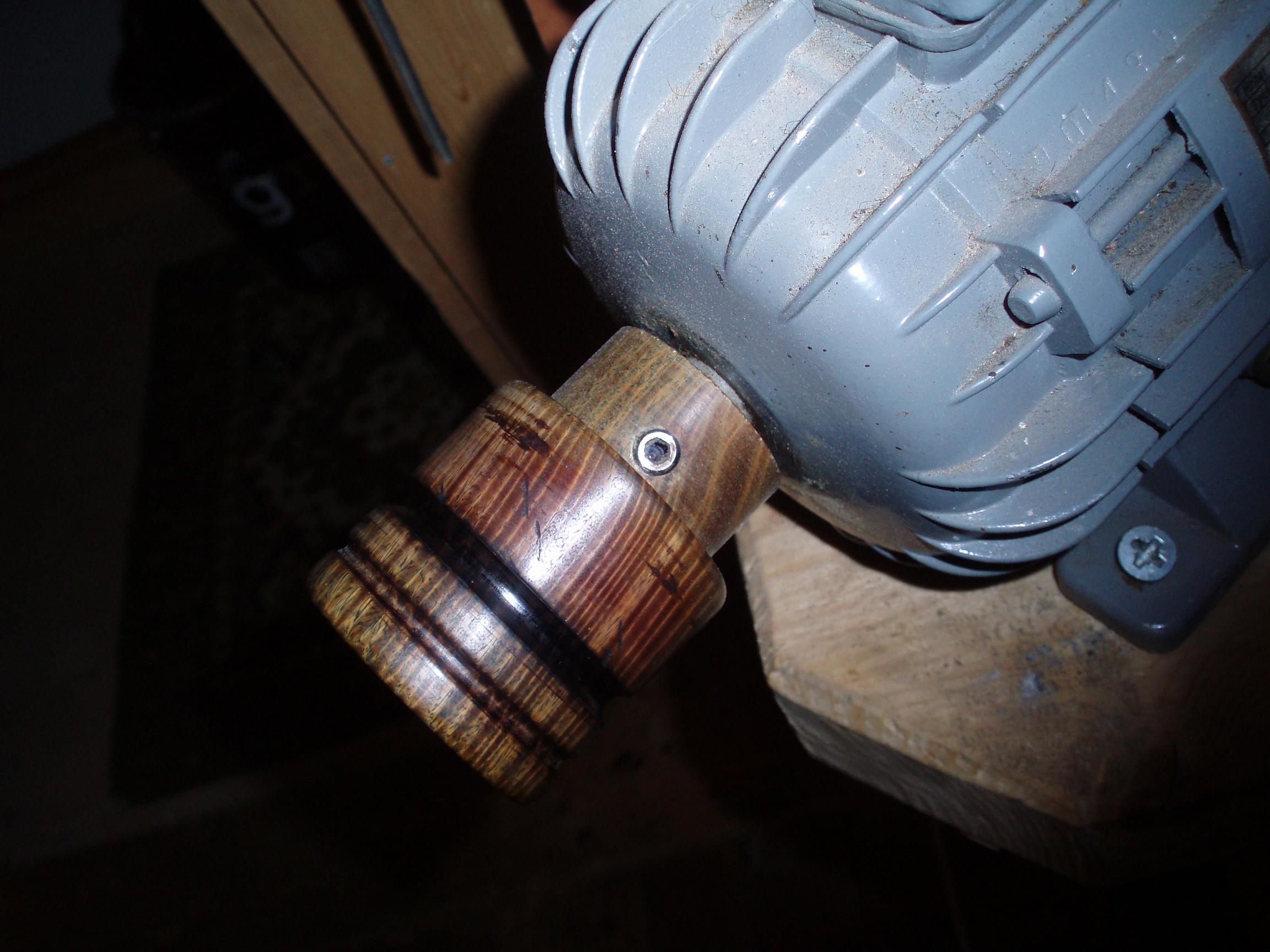

This is my burnisher: I turned a "knob" from Lignum Vitae, drilled a hole for the motor shaft, and drilled and tapped a hole for a locking screw. I then ran the motor and used a metal file, 1200 grit paper and steel wool to make the grooves.
