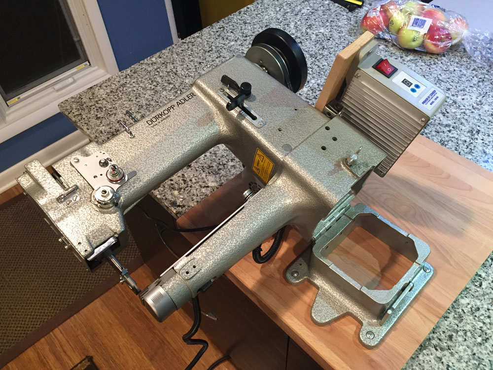

While I'm deciding on a permanent installation for my new Adler 69, I decided to make a portable table-top setup so that I can use the machine while I figure out some other details.
I used my Consew CMS 1000 motor where I had previously mounted the pedal mechanism on a separate board. I mounted motor and controller to the Adler 69 using existing bolts and holes. No holes were drilled and no paint was scratched on this pristine machine. A modified door hinge holds the motor and allows easy belt installation and tension adjustments. The mounts still allow tilting the machine back to get access to the internal bits.
It wasn't intended to be pretty but it's functional and compact. This approach may work for folks who don't have space for permanent table setups for each machine or need to travel with their machine for some reason. The whole setup is not exactly light-weight, but it weighs no more than my previous Pfaff 335 head by itself.
I took the pictures with the machine sitting on my kitchen counter ready to sew, just for fun. I don't plan on actually sewing in my kitchen, but now I could if I wanted to :) .

Nice idea again but how do you wind the bobbins? Does the winder fit on the small board?
~ Keep "OLD CAST IRON" alive - it´s worth it ~
Machines in use: - Singer 111G156 - Singer 307G2 - Singer 29K71 - Singer 212G141 - Singer 45D91 - Singer 132K6 - Singer 108W20 - Singer 51WSV2 - Singer 143W2
Posted (edited)
A standard belt-driven bobbin winder does not fit on this compact installation. This is where a stand-alone motorized bobbin winder comes in super handy.
There's no leg or foot actuated presser foot lift either, just the manual lever. The final, permanent installation will have a proper foot lift pedal.

or put a smaller pulley on the winder

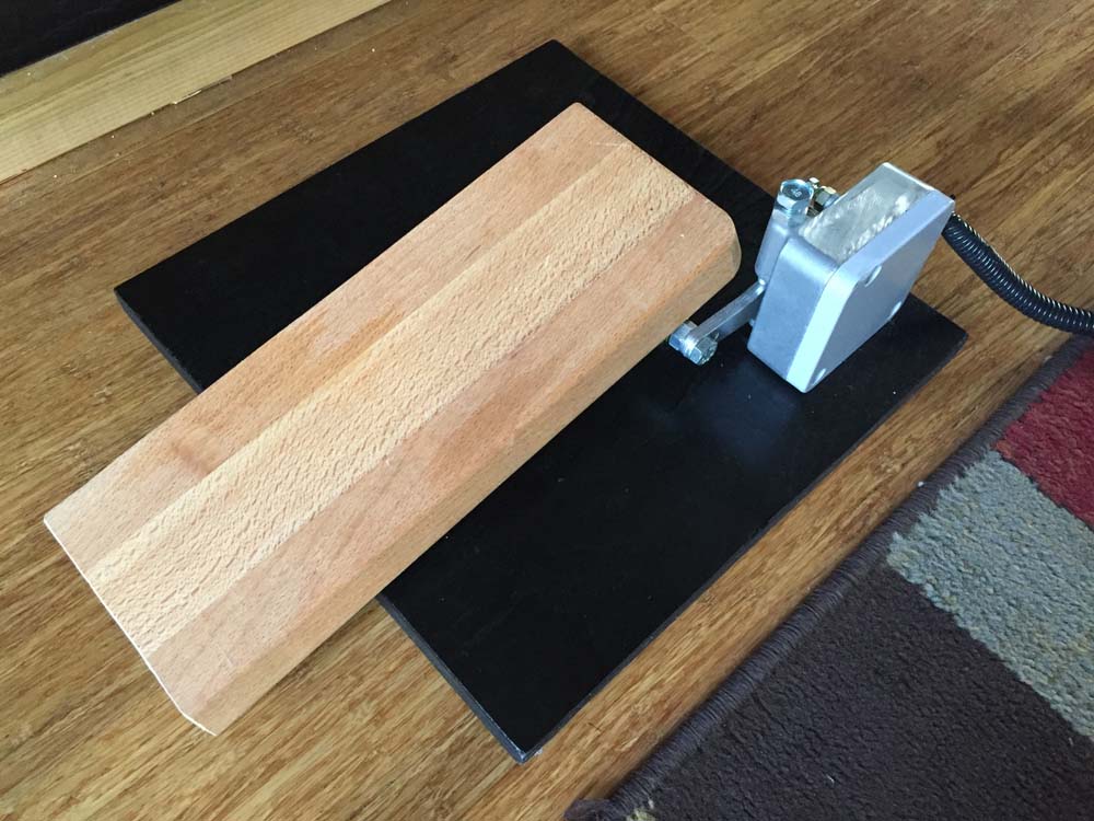

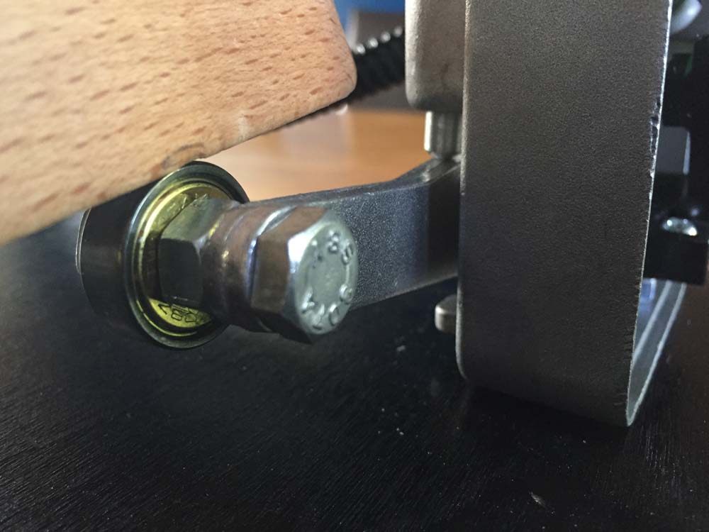

Very ingenious. How about a photo of the foot pedal arrangement? Curious, you know.
Machines wot I have - Singer 51W59; Singer 331K4; Seiko STH-8BLD; Pfaff 335; CB4500.
Chinese shoe patcher; Singer 201K (old hand crank)
Here are some detail photos of the remote foot pedal. The control box originally had some metal mounting arm sticking out at the top, which I sawed/filed off level with the top of the box. I made the connection wire longer by soldering an extension piece in the middle. The little skateboard roller bearing at the end of the control arm fits nicely on a 5/16" bolt and makes for very smooth pedal movements.
