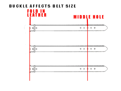

Search the web, and you'll find a BUNCH of "right" ways to measure for a belt - some downright weird. But, one issue at a time, perhaps. Ever seen one of those sites that tell you to measure from the fold in the belt? Here's why that doesn't work...

The first post is for leather people, though - not the customer. Once you DO have the right number, it matters what buckle you're using. Say someone measures their belt and tells you it's 35" from the fold to the hole they use. That's fine IF you're using the same buckle or a similar one. But take off a buckle that's 1" long, and put on a buckle that's 4" long, and now you have a belt that is 3" too big!
