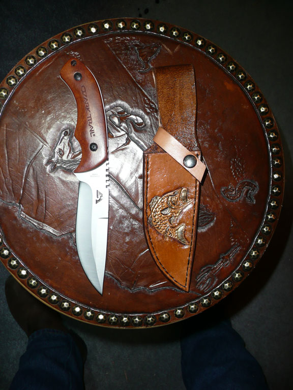

Howdy yall this is my first knife sheath and I would like to know what's good and what's a bummer .
this is a proud moment for me I designed it and made from scratch I have never used a kit for any thing so thanks for looking, and hope you can give me some input.
Josh
P.S. any thoughts are welcome and wanted.

the sheath is about 5.5 inches long where the blade is and another 3 inches after that

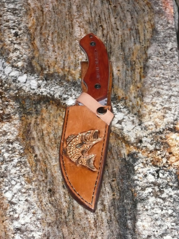

Got to tell you- that bass is REALLY neat!!!

You're doing great Josh!
Next time I'd give yourself a little more room between the tooling and the stitching. I keep learning something new with everything I make. That's part of the enjoyment to me is learning something new each time. I keep telling my family and friends that when I make something new the first one is always the worst one. The person that gets the latest one has the best one - until the next one. LOL

Nice job for your first go JBIRD...the bass is great!
Bring over a 6 of Bud Light and I'll show you how to make the back panel and the belt loop from one continuous piece of leather.

First off, that's a pretty cool sheath. I saved my first one just to give me a laugh on bad days. Yours is far better.
You need a groove cut where your stitching is. Otherwise anything rubbing against the sheath will cut into the thread. Also makes it look nicer.
The earlier comment about more space between the carving and the edge is a good one.
Why is the strap a different color?
Ooooh, the one thing that really stands out as a "needs improvement" is the way you sewed the belt loop on! That's single stitch doesn't have much strength. The loop should go further down the sheath in the back, allowing you some room to sew a square. (Actually, 3 sides straight and one like a "V".")
The loop is a bit short (as pointed out earlier). It would look better if the top of the sheath was angled to match the blade.
Again, it looks pretty good, but getting honest critique is the best way to keep improving. I wouldn't have said anything critical except that you asked.

My thoughts also.
The knife sheath looks very good. in fact its better than my first sheath
on your next one make the belt loop part of the back of the sheath leather.
when you design the sheath on paper draw in about 1/8' to 3/16" on each side right where the handle would stop and the blade begins. then just draw a straight line to right where the top of the handle is(the non blade side of the knife).
now allow lots of paper to fold this area over and end it on the sheath main body part 1" to 1 1/2" inches into the main body.
i then draw a half moon here and thats my pattern. then i stitch the half moon area and the 2 sides connecting straight across the leather.

The work is looking good Josh, and after reading the previous comments, I can only add one thing. It kinda goes in line with ArtS' comments, and it is: Spend about five extra minutes on the layout portion of assembly. That's it. You're progressing very well, and every project shows it.

the back panel and loop are one piece I just looped over and sewed it there not separate is that what you are saying

JBird, good first effort! A couple of suggestions: Dye the inside of the belt loop (and the inside of the keeper strap) a dark color - black, brown, etc.; round or point the end of the keeper strap; use the smallest edger you have on the keeper strap and the belt loop; use a contrasting but complimentary dye on the edges of the belt loop and keeper strap (requires a steady hand and the 'oh crap' factor goes way up!) ; in one photo (it is really dark and I may have mis-interpeted what I think I see) the spine side welt appears to be uneven, regardless, ensure all welt edges are sanded and burnished smooth; burnish all edges; and, my last suggestion is to pick up the piece, close your eyes and let you fingers explore the entire work piece and you will know what needs to be rounded, sanded, burnished, etc..

On the spine I used glass to even it out then sanded well then I slicked it heavealy then stained and two coats edge coat.

Hope this helps. First picture, front panel on the left, back panel with belt loop on right.Second pic, shown how they are sewn together. I used tiny little scraps, hope you can make sense out of it. You can still attach retainer strap like you did before.IMG_9967.jpgIMG_9969.jpgP.S. don't forget to skive a little b4 you sew....

The back side illustrating what Texas Jack a saying........fwiw - I much prefer (and so do my customers) an added loop rather than a one piece since I can get a much better fit on the blade, but the other option when making a one piece is is to turn the loop to the inside rather than to the back - skive heavily at the bottom edge on the flesh side for about one inch - to one and a half inch, glue so that 1-1.5" is down inside the sheath, then sew up the edges when you add the front piece (hope that makes sense - if you like at my Mex loop ho-to it sshows it sort of)
