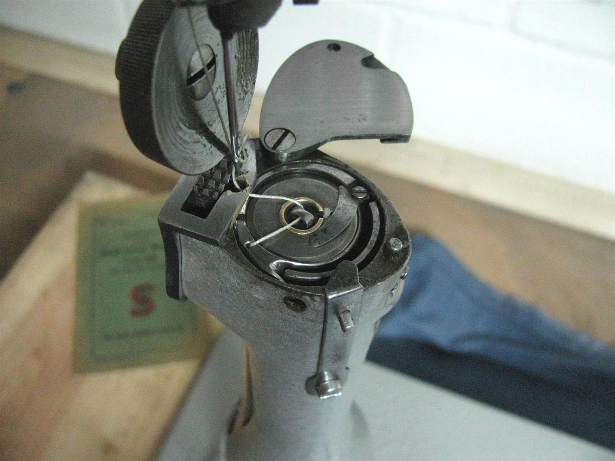

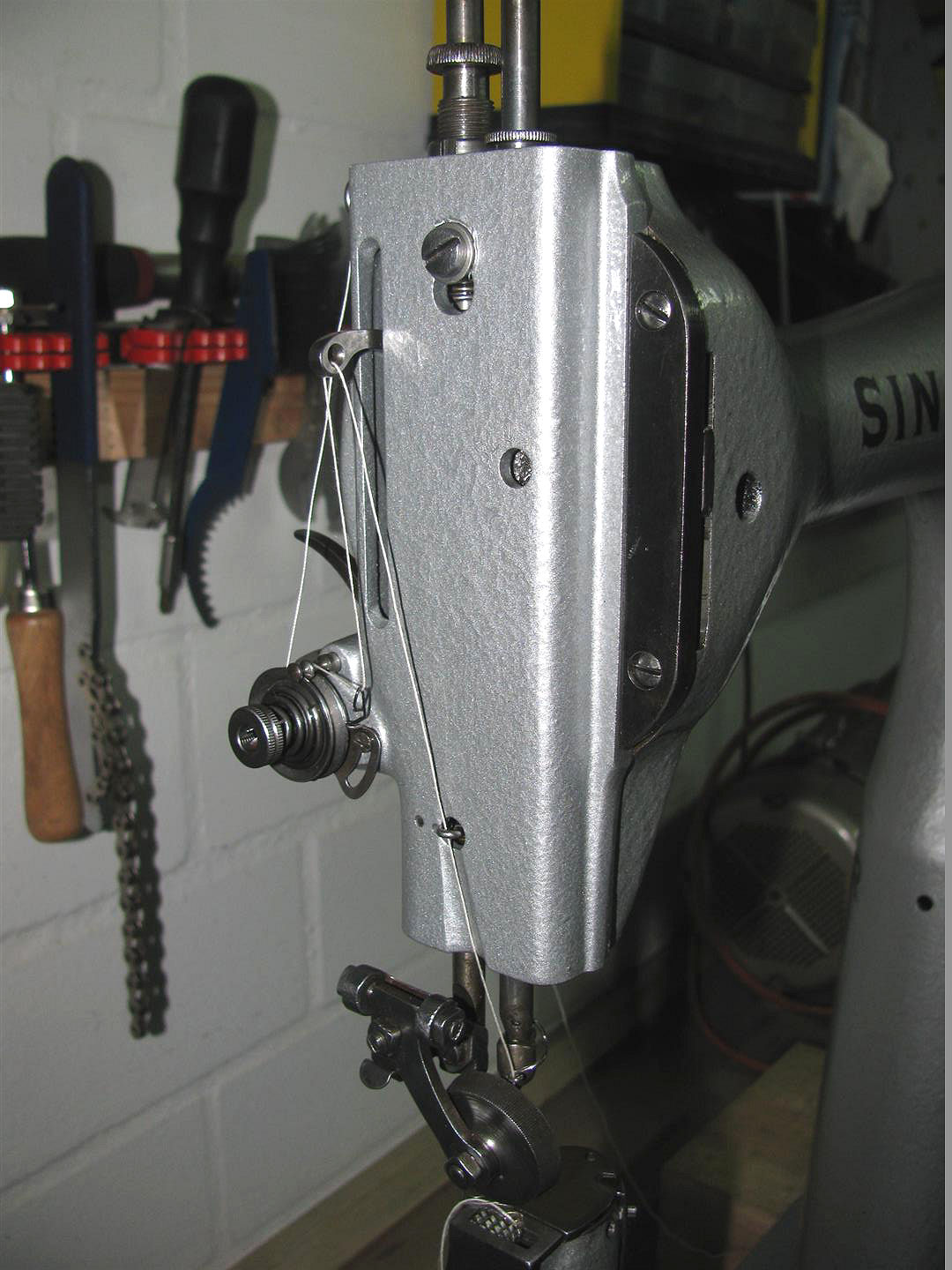

Members Constabulary Posted November 8, 2015 Author Members Report Posted November 8, 2015 (edited) Some pictures of the restored machine before the accident happened. Fortunately it fits in the cut out on my 1111G156 table (not perfectly but it fits and works) Edited November 8, 2015 by Constabulary Quote
