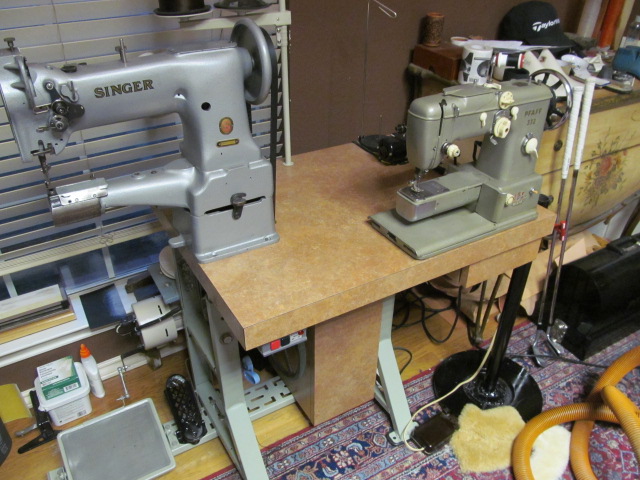

Contributing Member Ferg Posted November 14, 2015 Contributing Member Report Posted November 14, 2015 I have been thinking of doing one of these for some time, all the others showing their handy work, here is mine. I had an extra winder and thought a singer sewing machine motor would be the thing to use. Found Motor, extra brushes, belt, and foot switch for under $20.00. ferg Quote

CFM Tim Schroeder Posted November 17, 2015 CFM Report Posted November 17, 2015 (edited) This is my version of a separate bobbin winder. I think I saw one set up like this on Ebay. No belt just direct contact. These winders are great because you don't have to spin your machine so fast. I usually only have one big spool of thread so I will wind 4 or 5 at a time. Converted my regular sewing table legs to a cylinder arm table and then mounted the bobbin winder on the corner. Edited November 18, 2015 by Tim Schroeder Quote
