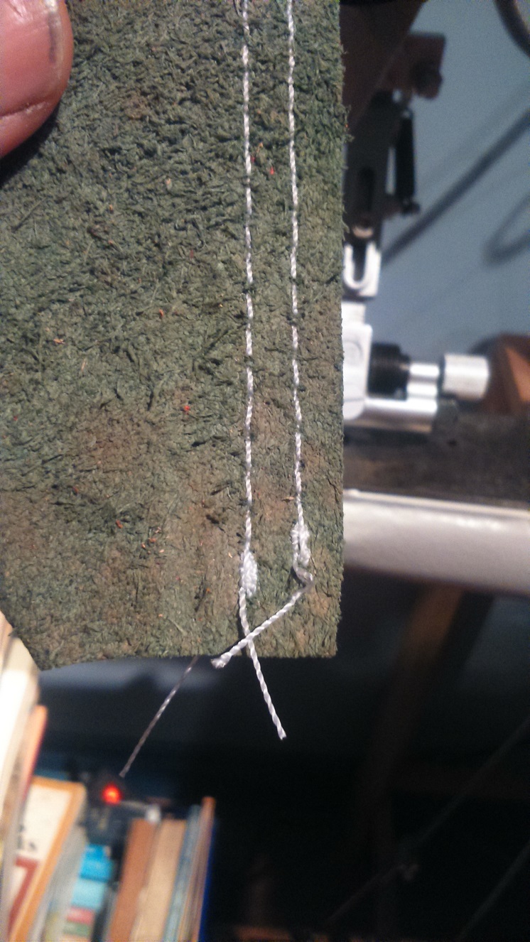

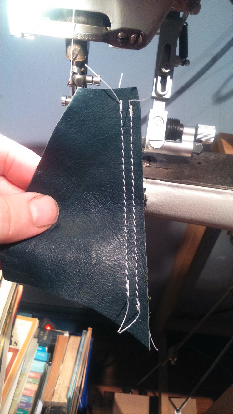

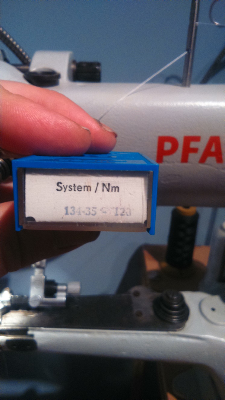

jimi Report post Posted November 18, 2015 (edited) Hiya Kat, i have tried with thinner thread and thinner leather 1 then 3mm then changed the thread from thinner to the one in the picture with the same needle 120 and this is the results. if i back stitch for a long length the thinner cheaper thread starts to untwist?? but does not bunch up underneath?? maybe try another type of thread if you have one handy, it might turn out perfecto?? regards jimi. Edited November 18, 2015 by jimi Quote Share this post Link to post Share on other sites
