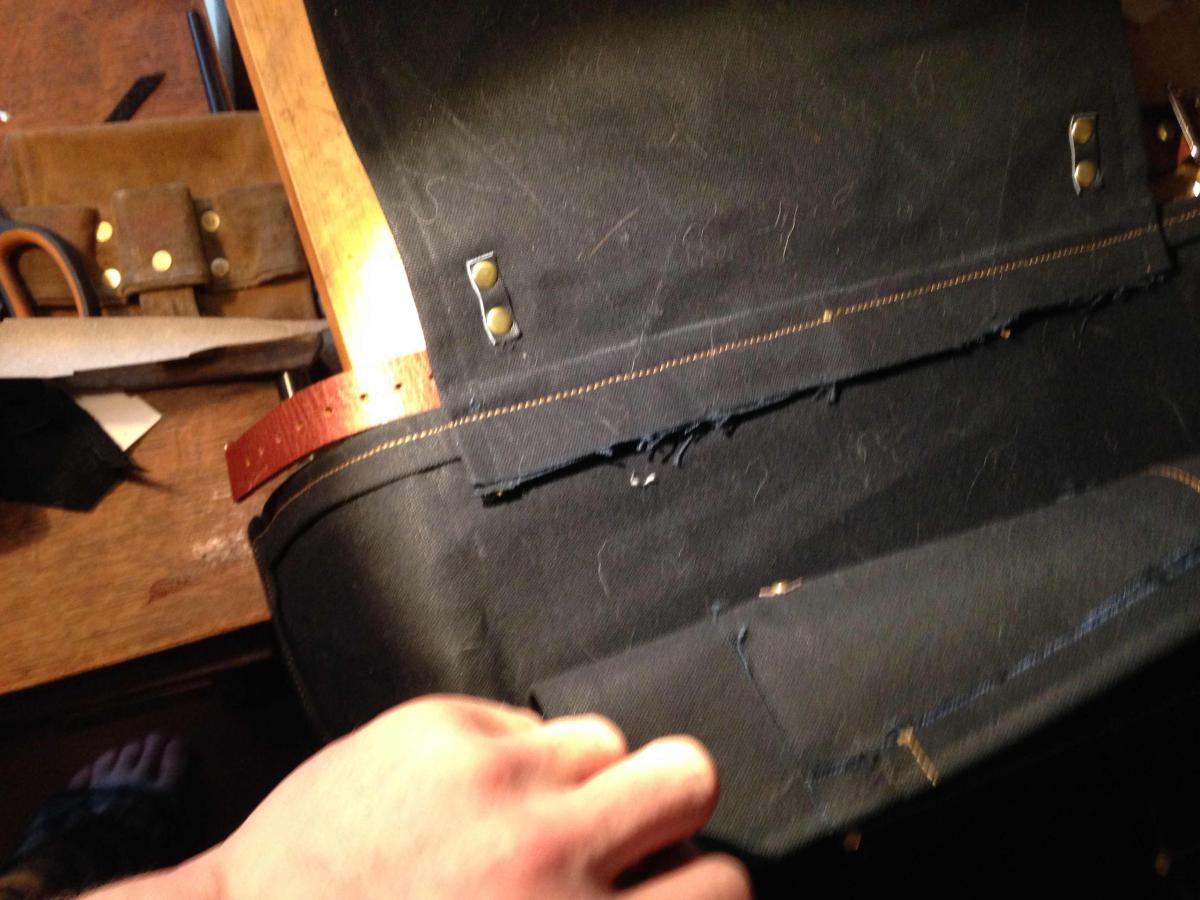

Members TinkerTailor Posted December 17, 2015 Members Report Posted December 17, 2015 I do all my canvas work, up to 10 layers 10 oz duck canvas, or 4 layers with some 3-5oz chrome tan, on a well maintained 1910 era White Rotary treadle machine. Old cast iron treadles can often sew quite well with heavier materials. They just are not quite good enough for leather so most here look at them as toys however they are generally pretty capable machines, and can be had for cheap if you look. Only issue is bobbin size is pathetic with bigger thread. It is accurate enough that i can stitch back into the same holes, and double stitch seams which need extra strength. Sometimes, they end up looking like fatter thread, not two threads. These are done on that machine:(excuse the cat hair, he liked to sleep on my bench when i was gone......) Don't tell the sewing machine experts this one cause its not supposed to work: I have even run 2 different colour threads top and bottom at the same time. You read it right, 2 thread top, 2 threads bottom. Don't ask me how it made loops and didn't miss stitches, i don't get it....but it worked. I just wanted to see what would happen. Quote "If nobody shares what they know, we will eventually all know nothing." "There is no adventure in letting fear and common sense be your guide"
