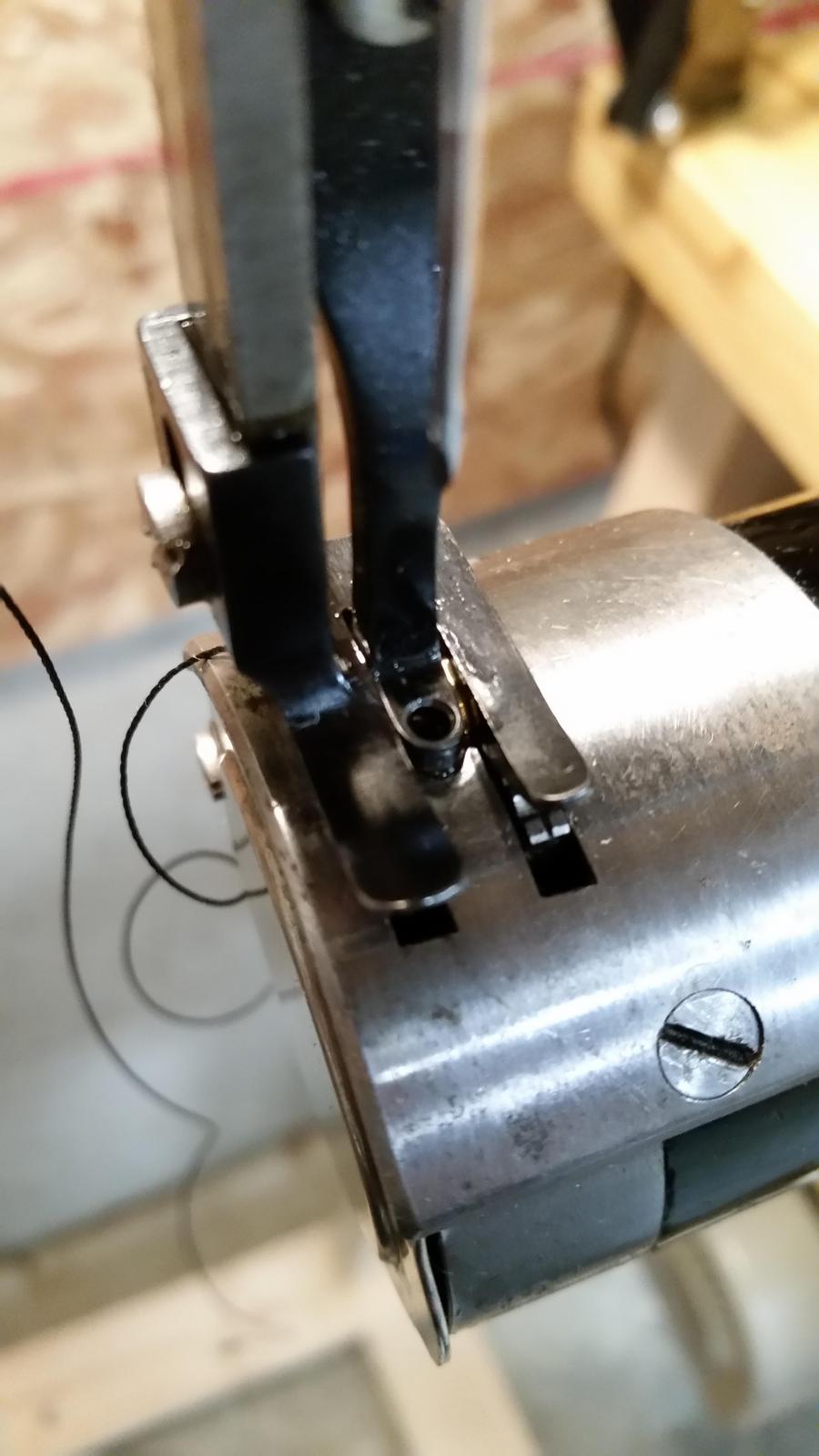

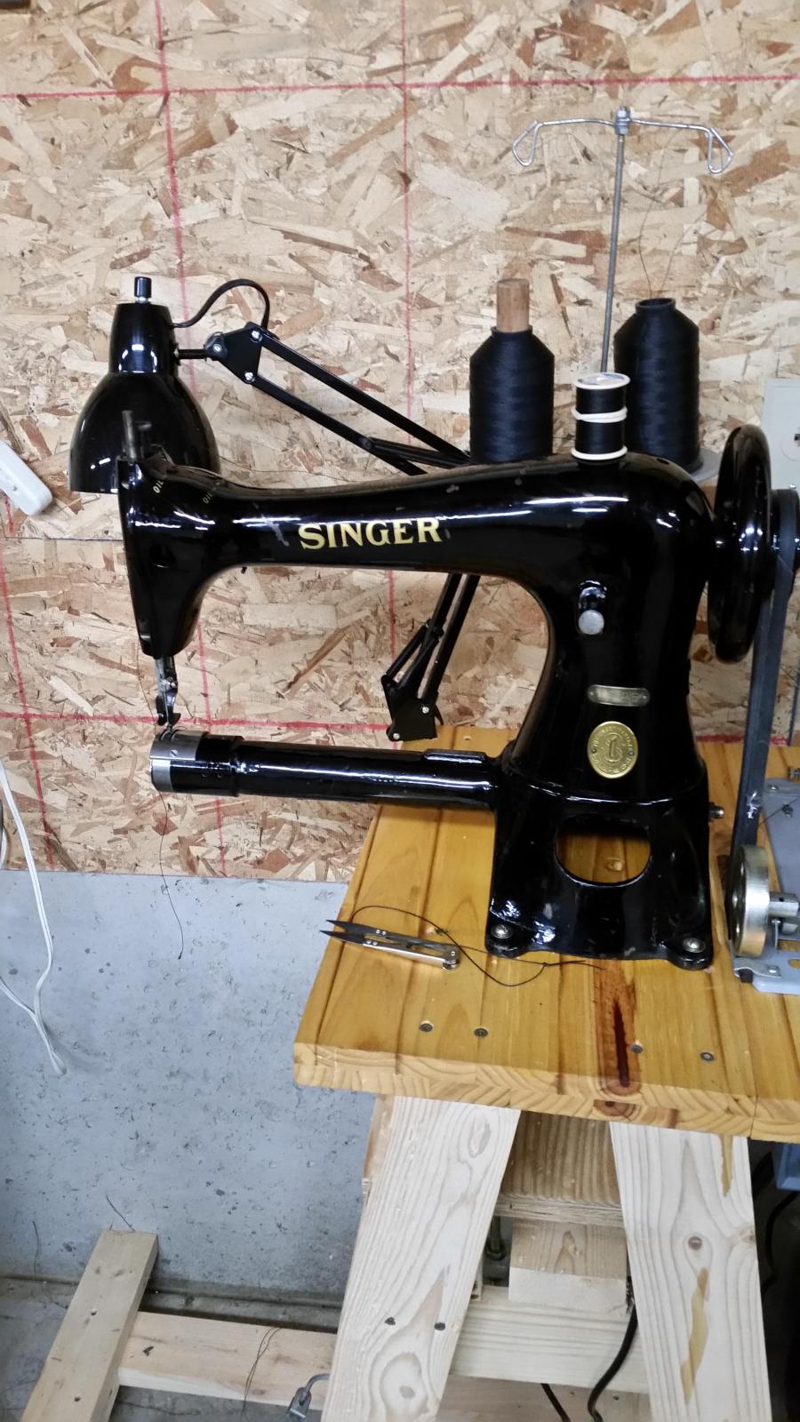

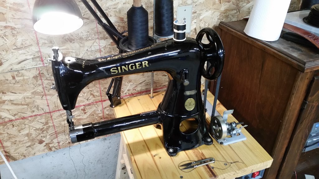

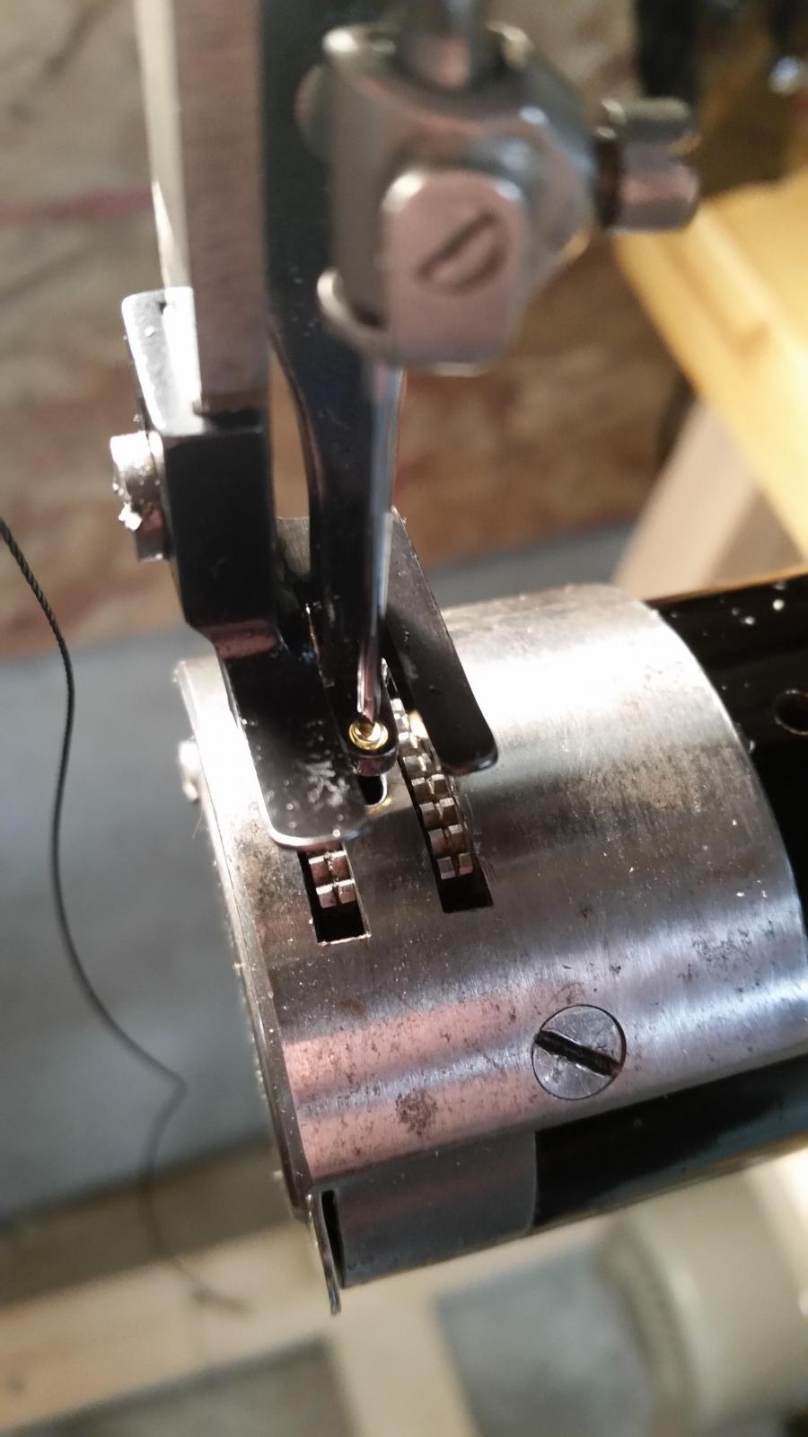

Members BigMatt Posted December 31, 2015 Author Members Report Posted December 31, 2015 Here are some pictures. .. Quote https://tiekenleather.wordpress.com/

Members jimi Posted January 1, 2016 Members Report Posted January 1, 2016 In the pictures the feed dog has big flat spots, adjusting the height wont fix it i reckon. unless you file them to a point again and then you will possibly have to widen the elongated hole underneath on the bottom side of the feed dog. the other option is get someone to TIG weld the top of the feet and then file them down again to the original height. you might even find some new feed dogs somewhere on the net?? but you will probably have to change the needle plate also as two rows of teeth are probably not out there for the class 17 machines. http://stores.ebay.com/SHARP-SEWING-SUPPLIES/_i.html?_fsub=439427819 Quote
Members Darren Brosowski Posted January 2, 2016 Members Report Posted January 2, 2016 That machine has been repainted as they were not that glossy when they left the factory!!! I bought three 17-25's at one time and all were incomplete so there were enough to build one jump foot, one roller foot and one as a darner. Many parts are available from Seiko as they build the 17 class as the TF but I don't think the double row feed dog is one of them. Bob Kovar would be the best person to ask. Quote
Members BigMatt Posted January 2, 2016 Author Members Report Posted January 2, 2016 Thanks for the info. I adjusted the feed dog and it helped, but just barely. After looking at the action a little closer, I believe I have all the stitch length I can get. I will be sure to be careful when adjusting it down. I will be sure to check out the Seiko equivalent models. Quote https://tiekenleather.wordpress.com/
