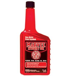

Uwe Posted January 4, 2016 Report Posted January 4, 2016 (edited) I'm using Marvel's Mystery Oil to clean my machines. It works well to dissolve old crud and dried oil varnish. It's basically diesel oil that doesn't look or stink like diesel oil. Edited January 4, 2016 by Uwe Quote Uwe (pronounced "OOH-vuh" ) Links: Videos
Thor Posted January 4, 2016 Report Posted January 4, 2016 Alex, sorry I forgot you are in Germany like me. We have better products in the local building supplies than what I suggested. What Uwe suggested would also be found in the grocery store in the washing detergent aisle called "Waschbenzin". This basically is cleaned Diesel and the reason why I suggested it. I can't judge from the pictures you provided whether it will all come off or not. Depending whether the paint itself contains metal or not. Most of it should come off. You may have to use a buffing wheel though. I'd take it apart anyways. Quote
