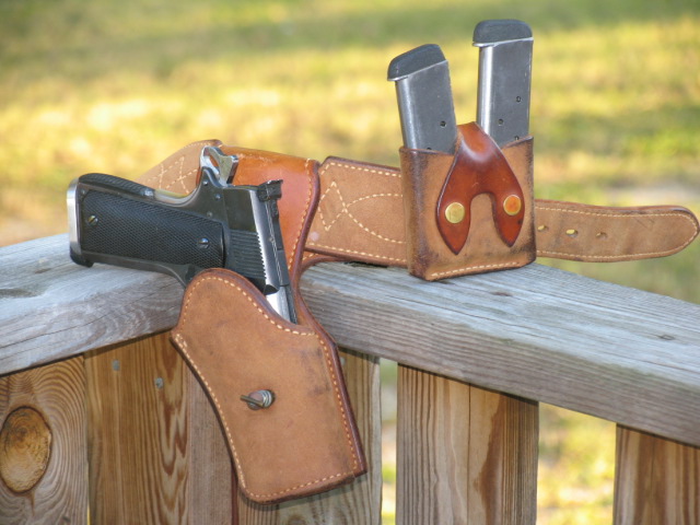

Members Red Cent Posted January 9, 2016 Members Report Posted January 9, 2016 Mine are built for SASS and most do not like the tight to the body position of the grip. That is why my screws are lower. And I leave a large curve where the flap goes over the belt. If the buyer wants to wet it and compress it, they can get the close to the body grip position.The extended backflap provides additional stiffness. Mernickle has two T-nuts just under the belt that snugs the holster to the belt and it will not move. Bob built my first custom rig around 2003. He places a third screw at the bottom of the back flap. This arrangement is typical of the IPSC/USPSA holsters back in my time. Kirkpatrick uses a sandwiched T-nut as I do mounted on the inside of the back flap to keep the holster from coming up with the gun in case, heaven forbid, one would make a clumsy draw. A holster made with a thickness equal to approximately 14 ounce leather with the additional strength of the glue and good stitching will make for a lethal weapon. Mine will sound like a hollow log if you tap it. Combine that with a belt of about equal strength and you do not have any flex. The attached picture is one of G.W. Davis, an originator of SASS and a highly gifted holster maker. I have this rig in rough out. Picture also attached. Note the extended back flap. Davis ran with Alfonso, Andy Anderson, Ernie Hill, and others. And thank you Dikman and Tugadude. BTW. And I apologize for the blatant showing off.http://www.mernickleholsters.com/ca/CA23_23/ca23_23.html Quote https://www.facebook.com/redcentcustomleather?ref=bookmarks http://www.redcentcustomleather.com/
