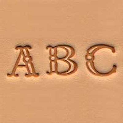

This is the set you're using right?
Why dont you try running a resist (resolene?) into the stamp depressions using a fine brush, then dying the raised portions also using a fine brush? Then when dry, run more resist over the whole letters before dying/airbrushing the rest of the collar?
Edited by Martyn
If you're using the 3/8" "fancy" set that Martyn has pictured above, I would do the base colour across the whole strap and then follow up with an antique to make the letters pop. Remember to buff well!
To my mind - that fancy set has so little area to work in that I wouldn't consider using a brush.

Martyn, Penquineer and Colt, thanks a lot for the additional input. Yes, that is the 3/8' letter set I used. Martyn, I agree that using a resist in the lower depressions and a darker color on the raised areas would look awesome. Unfortunately I'm beyond that point already, and unless I totally remade the strap - which I don't think I'm going to do, I'll have to try that another time - definitely on a practice piece first.
