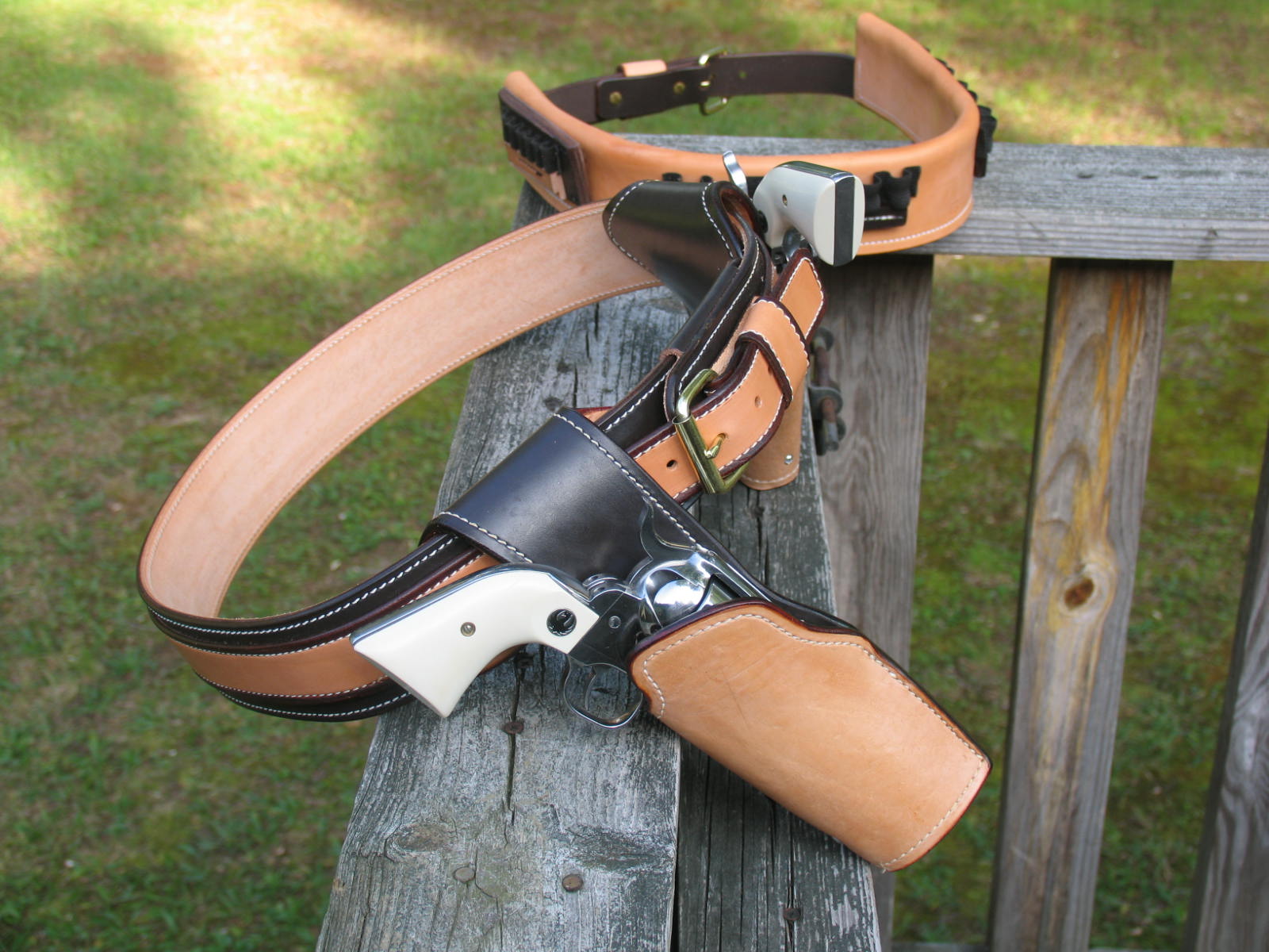

Members Red Cent Posted March 30, 2016 Members Report Posted March 30, 2016 (edited) I use the dauber, the one with a cotton ball on the end of a piece of wire. I do burn the fuzz off. I do not dye a raw edge. The dye will be sucked in erratically. If I am making a CC gun belt that is 1/4" thick, I take the glued (dried) together belt to the belt sander. I square the edges and make sure there is no smear from either piece of leather. Two defined pieces of leather. I bevel all edges with a #3 beveler on all sides. Then I hand sand the edge round leaving the defined line of the beveler on the belt side of the line. I use a little water on a rag to wet/dampen the edge of the leather and use a motorized burnisher. Usually this produces a glass like rounded edge colored as only a burnisher will do. Let it dry. I do not use edge dye, edge kote, edge enamel or other stuff. I simply dye the edge with a choice of regular dye. I dye a path at the top of the curve the full length and both sides of the belt and then I slow down and do the edges. Be careful and not overload the cotton ball. And, hold the object in such a manner if the dye does run, it runs down the edge. PS: Find a place to steady the arm/hand. A semi loaded cotton ball will produce a better line than a barely wet one. With practice, you can create a crease in the cotton ball and use this to create an even line on the edge. Don't try to stretch coverage. Do a safe 8" or so AND use the beveler line as a fence. The dye will stop (within reason) at the fence and soak in. About an hour later burnish. I have found that different leathers will react....well, differently. Some react by dulling the dyed edge. Stop and grab the faithful, very smooth and well used dowel rod. Rub light and vigorously at first. With my belts, I lay the belt along the edge of table and hand burnish. You can create a very straight burnish line doing this. Turn as needed. Hmmm, I wrote a novelette. None of these have an acrylic coat on the edges. The third picture (sorry) is simply water and burnisher . Really. I do add a mixture of bees wax and paraffin to the edge and "burn" it into the leather with the motorized burnisher. Edited March 30, 2016 by Red Cent Quote https://www.facebook.com/redcentcustomleather?ref=bookmarks http://www.redcentcustomleather.com/
