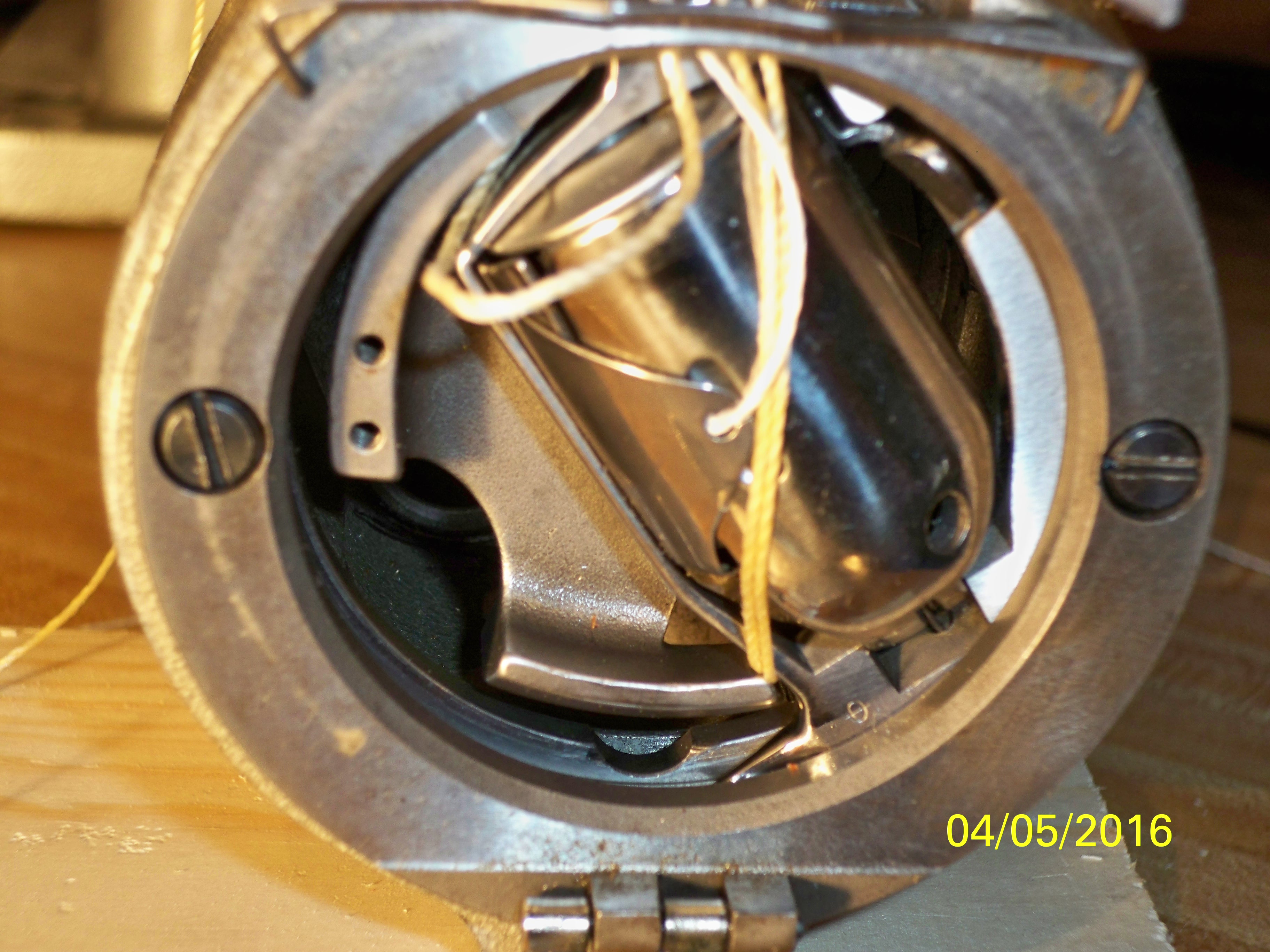

Members Ken Nelson Posted April 4, 2016 Members Report Posted April 4, 2016 How much play (slack should there be in a shuttle on a 900B. Mine is too tight to allow the thread to complete its journey around the shuttle to form a stitch. Any fixes out there? Thanks. Ken Quote

Members Ken Nelson Posted April 4, 2016 Author Members Report Posted April 4, 2016 The problem seems to be there is almost no slack between the shuttle driver and the the shuttle. My Cobra Class 4 has slack between the shuttle and the driver. This machine was built up from a consew 754. I am wondering if someone replaced the shuttle with one that doesn't fit correctly or if I am missing something here. Ken Quote

Members Ken Nelson Posted April 5, 2016 Author Members Report Posted April 5, 2016 It is not letting 346 pass or is it working with 277 on the top. This machine had not been used for a long time, and it had 69 top and bottom with a 200 cloth needle in when I got it. I am sending pictures to a tech tomorrow and will try to get some posted here tomorrow night. I am thinking new driver may be required. might try to alter the one on it before I order a new one. These machines started life as a Sieko and basic parts are still available for them which is a huge +. Thanks all. BTW Wiz, already tried what you suggested. I wish I had your knowledge on these things.Ken Quote

Members Ken Nelson Posted April 5, 2016 Author Members Report Posted April 5, 2016 I spoke with Dan Nagel at Campbell-Randall last evening. He indicated Juki 441 Bobbin and the shuttle for this machine interchange and it looks and measures the same as my Cobra Class 4 shuttle. I am going to try to get a picture posted here today. Good idea by the way. Thanks Ken Quote
