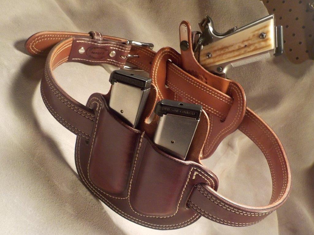

Members Josh Ashman Posted May 20, 2016 Members Report Posted May 20, 2016 Just finished this up and thought it turned out pretty nice. Quote
Members SLP Posted May 20, 2016 Members Report Posted May 20, 2016 That is beautiful work! Also, that glisten along the edges did not go unnoticed. Very nice! Quote

Members Forester Posted May 29, 2016 Members Report Posted May 29, 2016 Real nice, what finish do you have on it. Forester Quote
Members Josh Ashman Posted May 31, 2016 Author Members Report Posted May 31, 2016 Thanks! Forester, the brown is some drum dyed that I picked up from SLC a while back. The tan is Fiebings cut to 2 parts dye with 1 part rubbing alcohol applied with a scrap of shearling. A very light coat of neatsfoot oil that sat overnight to "soak" in. Followed by a dunk in 50/50 Mop& Glo and water. Once that is dry I rubbed a very small amount of Kiwi neutral polish on with my finger tips and buffed it off with a soft cloth. Quote

Members klaykrusher Posted June 5, 2016 Members Report Posted June 5, 2016 (edited) Josh, that is real nice looking! Question on the holster build process, do you apply the color, stitch and then mold? Basically just wondering how you keep the dye off the thread and changing its color. Also, wondering why the saddle soap as a last finish step in your western rigs, just wondering what the benefit is. Appreciate it! Edited June 5, 2016 by klaykrusher Edit Quote
Members Josh Ashman Posted June 6, 2016 Author Members Report Posted June 6, 2016 Thanks Klaykrusher! My process is; cut out, tool/carve (if there is any), dye, glue, sand edges, sew, bevel & dye edges, mold, top coat. If I want the stitching the same color as the leather I move the dye step back to right before it get's molded. I like to use glycerin saddle soap on my western rigs and tack because it seems to shine up the right amount. It also leaves the leather feeling an smelling the way I like. I'll spay a little on a scrap of shearling then sometimes wipe that across a bar of SS as well, then rub it into the leather, let it sit for a while and buff it off with a soft cloth. All the best, Josh Quote
