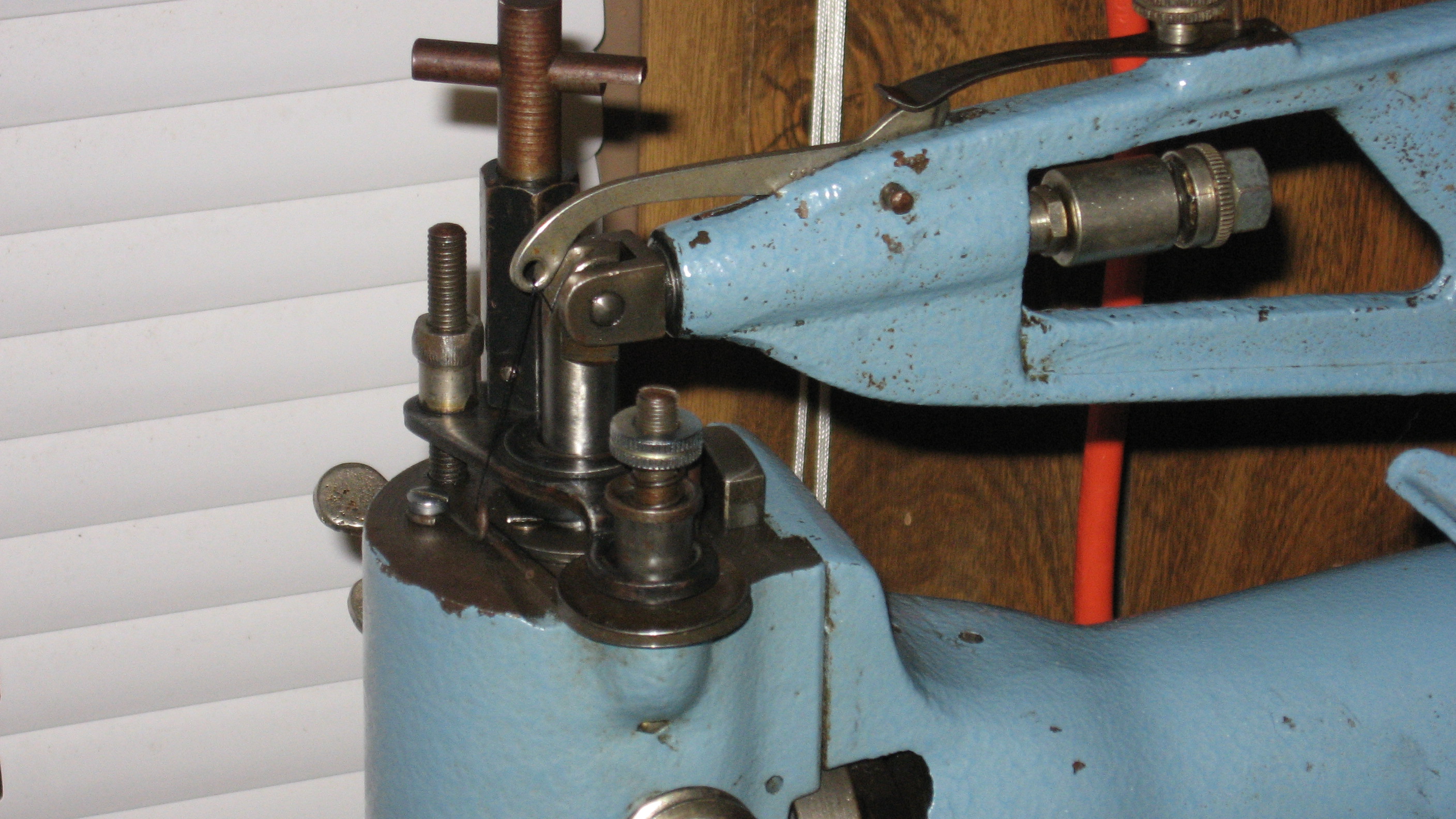

mikesc Posted June 15, 2016 Report Posted June 15, 2016 If it has the top mounted darning attachment it can sew long stitches manually. Would you have a picture of one of these darning attachment contraptions Wiz ? First time I've heard of it .. re the machines..the top "elastic " one looks very much like the machines ( various manufacturers ) which show up on our version of Craig's list ( "le bon coin" ) usually sold as machines for cobblers ( cordonniers, derives from the word Cordova, as in Cordovan leather ) or antiques for decoration, in working order they are about €700.00 and non working the average price is around €500.00.. Quote "Don't you know that women are the only works of Art" .. ( Don Henley and "some French painter in a field" )

Moderator Wizcrafts Posted June 15, 2016 Moderator Report Posted June 15, 2016 1 hour ago, mikesc said: Would you have a picture of one of these darning attachment contraptions Wiz ? First time I've heard of it .. re the machines..the top "elastic " one looks very much like the machines ( various manufacturers ) which show up on our version of Craig's list ( "le bon coin" ) usually sold as machines for cobblers ( cordonniers, derives from the word Cordova, as in Cordovan leather ) or antiques for decoration, in working order they are about €700.00 and non working the average price is around €500.00.. Here you go! This is my 29k172, long arm, large bobbin patcher, with a darning attachment. Quote Posted IMHO, by Wiz My current crop of sewing machines: Cowboy CB4500, Singer 107w3, Singer 139w109, Singer 168G101, Singer 29k71, Singer 31-15, Singer 111w103, Singer 211G156, Adler 30-7 on power stand, Fortuna power skiver and a Pfaff 4 thread 2 needle serger.
