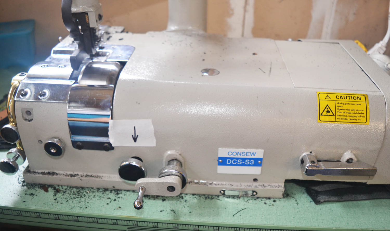

RockyAussie Posted July 14, 2016 Report Posted July 14, 2016 Nice pics of what the culprit has done but none of the culprit? Please see below one of my skivers that is now in need of a sharpen. Take no notice of the brass roller that is just something I made up to make soft and glazed crocodile easier to skive. Its just a bit of brass i shaped down to match the grind stone feed wheel in shape and a concrete nail smoothed out and put through.Helps to stop friction. Please send some close up pics of your machine to analyze.Do you have the dressing stick for inside bell and do you know how to use it? Quote

RockyAussie Posted August 24, 2016 Report Posted August 24, 2016 Note below pic shows the feed stone is near to level with the bell edge. If the gap on yours is too large a gap at the front you will get what your pic shows. If you have the front of your presser foot to much angled down at the front you may also be able to get this to happen but as I've said before some pictures close up of the machine would help anyone to see the problem better. These are a machine with a lot of adjustable parts and take a few years to master well and without knowing the machine and how you have it set up we would all be guessing here for end-um. Quote
