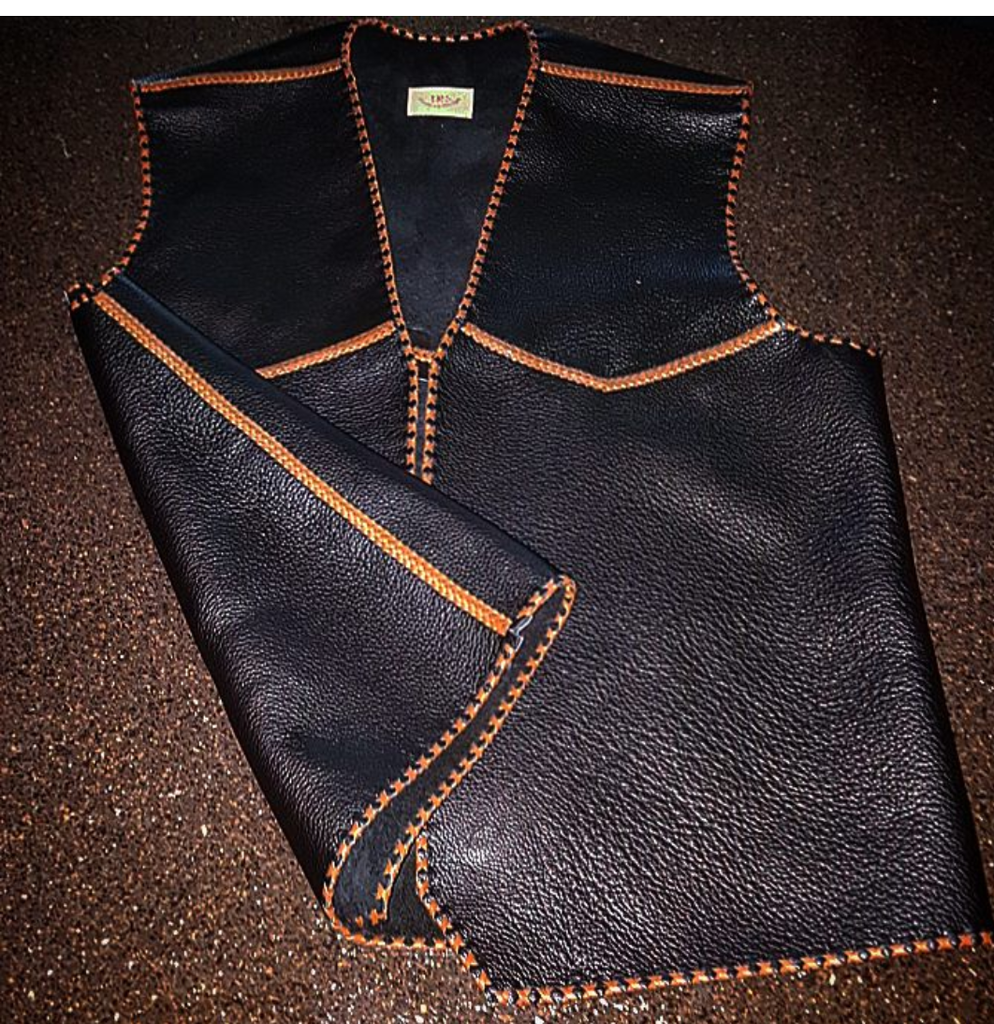

Finally finished a leather vest I have been working on for what seems like forever. This is the first vest I made which was a request from my younger brother, took some time since he travels so getting the custom fit took some time, I would get sizing and fitting done any time he was in town. I used a pattern from Tandy and made a paper version of the vest out of construction paper then marked any desired changes on the paper then transferred to leather. Thanks for looking!

Wow. That looks fantastic!
Nicely done! I like the design you made along the trim with the lacing. Could you get a close up shot of it or did you already give it to your brother?
Very nicely done.

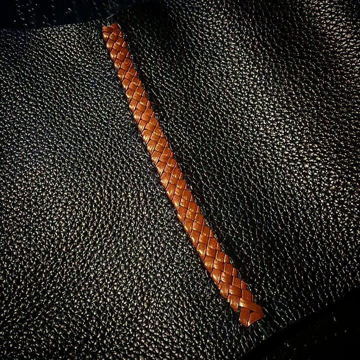

All the seems are done like this, which I believe is a Mexican braid or round braid
Nice. So the black diamonds along the bottom just come from the way the Mexican braid is done?
actually seems are done in the braiding and the edges are just crossed lace. I went every other hole in one direction and then every other whole in the other direction. I was going to do the braiding on the edges but after doing all the seems I wasn't mentally ready to do the edges...lol...plus I think it gives it a nice contrast with the crossed lace on the edges.
