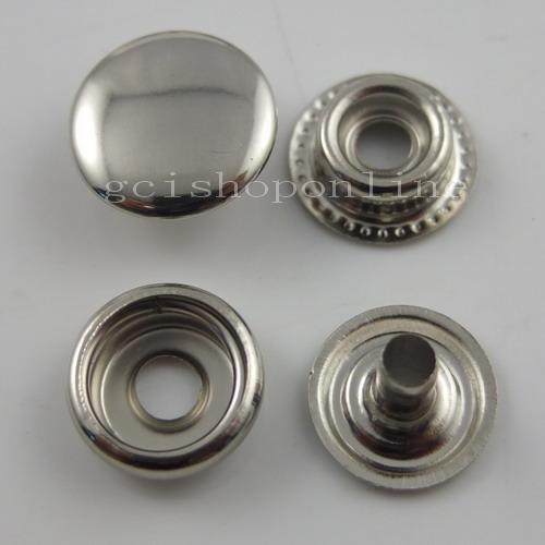

Are there any snap buttons, that are prefered for leatherworK? I've came across for only these two (different pictures), where one has the "male" part with the hole (second picture), for which I think, that they are meant for thicker leather, while the top picture one's are meant for thinner leather.
Am I right or is this user's preference only?
Typically, the first type is used for thinner and more flexible leathers. It has a less firm hold. The second type is used for thicker and stiffer leathers and has a very firm hold. If you use the second type with thinner leathers, you're probably going to distort the leather when opening whatever's being held together by the button, because it has such a firm hold. Conversely, if you use the first type with thicker and stiffer leathers,  the two halves will often pop open by themselves when any movement or bending is involved.

Longer studs are of course meant for thicker leather.  Too short, will fall apart.  Too long and they will often bend to the side, making a mess of the snap.
Tom
Also 1st type snap buttons should be 12.5 mm diam. or more (last four on the photo from a glance). Less ones are more suitable for cloth or very thin and soft leather (gloves e.g.)
Edited by AlexFJ
Depends on the leather weight. Of course in general you use larger snaps on leather, than on textiles. and you want about 2-3 mm of the stud above the floor of the snap body when pressing to make a nice symmetrical round crimp. There are snaps with gigantic studs for golf bags and similar applications where multiple layers of leather and plastic have to be pierced. So it all depends on your application.
