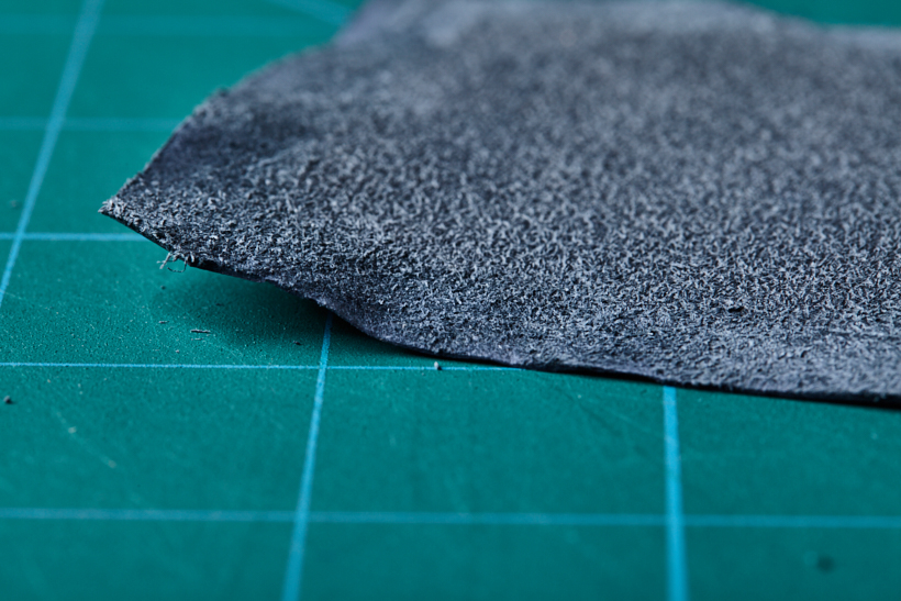

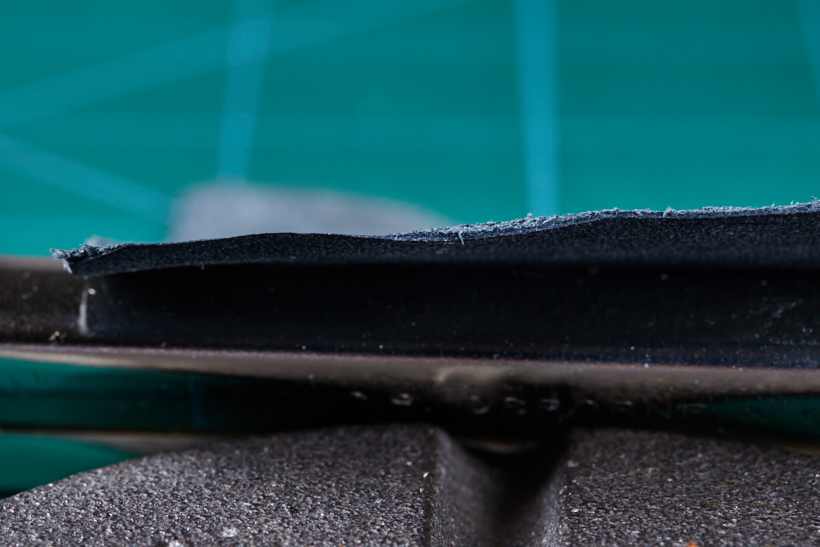

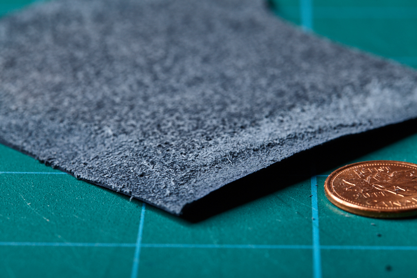

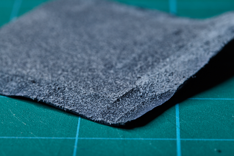

CFM Hardrada Posted August 25, 2019 Author CFM Report Posted August 25, 2019 Alright, took some photos of the problem: This is how the leather gets all bent out of shape: Very inconsistent thickness: I thought of thinning this wallet, as I was using four layers of 3 oz. leather and the thickness was making punching stitching holes a chore (they'd come misaligned on the bottom). I also thought that maybe the wallet would look nicer with thinner edges—now I'm not so sure. The one on the left is a test I made with scrap leather—which was also a PITA to skive and got all bent out of shape (I had to trim it again using the patters after skiving: it was that bad). Quote
