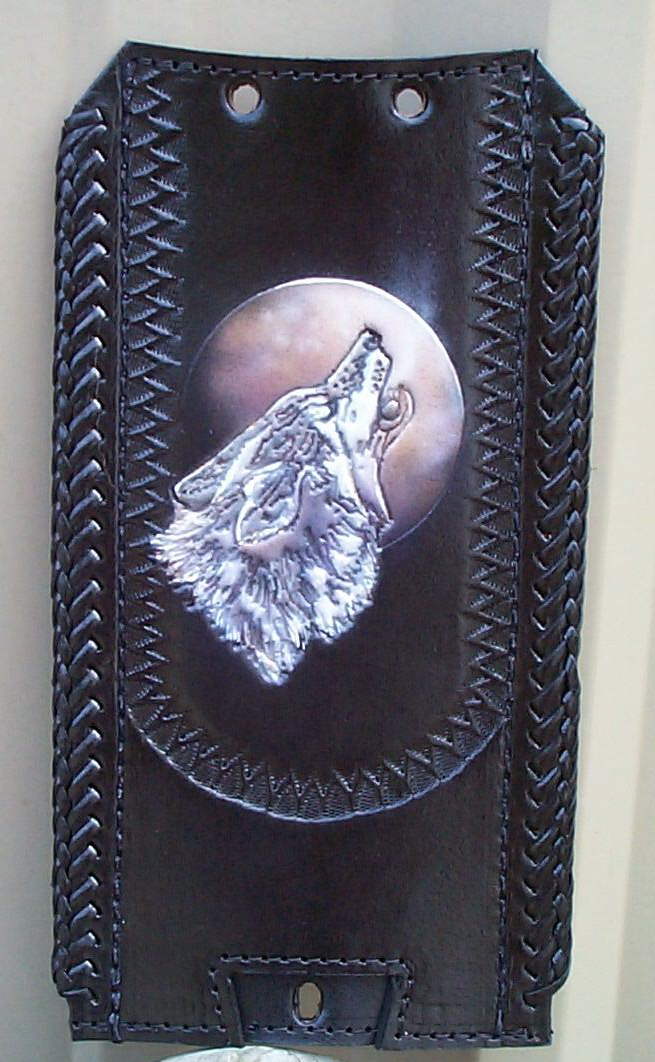

Members TimberWolf Posted September 26, 2007 Members Report Posted September 26, 2007 Hey all, completed these tank panels today. They fit a Harley Davidson Softail 00-08. The wolf panel is made from Wickett/Craig harness tooling leather/ 10 oz., with airbrush finish and braided leather edges.. The buffalo skull tank panel is a pocket style. The art work is airbrushed on a thin 3oz. tooling kip. Pocket portion is Siegel Diamond Tan black, base is Wicket 10 oz. latigo. Thanks for looking! Tim Quote Tim Wolf, http://timberwolfleather.com
Ambassador Beaverslayer Posted September 26, 2007 Ambassador Report Posted September 26, 2007 Hey Tim, Again some great looking work, I love your airbrushing. What are you using for colors? One thing though, have you tried the "Left Handed" lacing? By doing that your lace will be symetrical on both sides of the panel. Ken Quote Beaverslayer Custom Leather<br />Wearable Works of Art https://www.facebook...erCustomLeather
Members SScott Posted September 26, 2007 Members Report Posted September 26, 2007 TimberWolf, Super nice work,what do you use for a top coat? SScott Quote
Members TimberWolf Posted September 26, 2007 Author Members Report Posted September 26, 2007 Thanks, Ken!! The colors I use in the airbrush are dyes made for the shoe industry, but the company, Artistic Chemicals, was sold a few years ago and I am having a problem replacing colors. The suppliers that carried it no longer do. I may have to experiment with other airbrush dyes. Braiding: I need to practice the lefty braid....time to dig into the scrap box. I agree, the braid would look more symetrical, but my hands don't want to cooperate!! LOL! Tim Quote Tim Wolf, http://timberwolfleather.com
Members TimberWolf Posted September 26, 2007 Author Members Report Posted September 26, 2007 Thanks, Scott! The top coat is Fiebings Saddle-Lac spray. I have used it for years. It is a good choice for leather that will be outdoors much of the time. Tim Quote Tim Wolf, http://timberwolfleather.com
