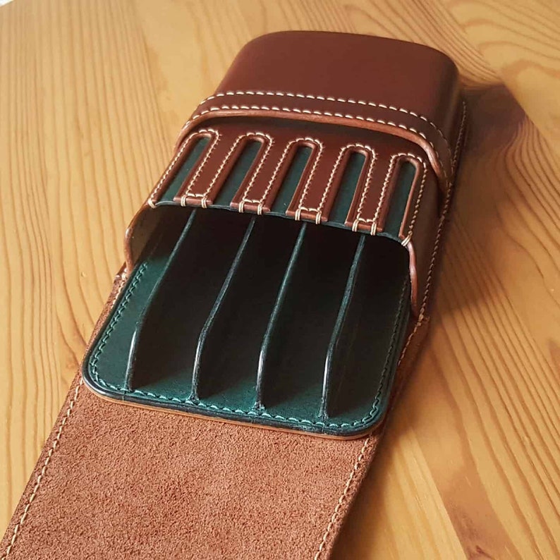

Selecting tools is definitely difficult when it is unclear how to get the results I want. I have attached some photos of the kind of things I would like to make. I also am fond very fond of Hermes, Moynat, Berluti, Dunhill, Goyard (full leather products). I don't know if this would guide my tool selection.

Yikes. I was quoted over $600 for that pen case.
