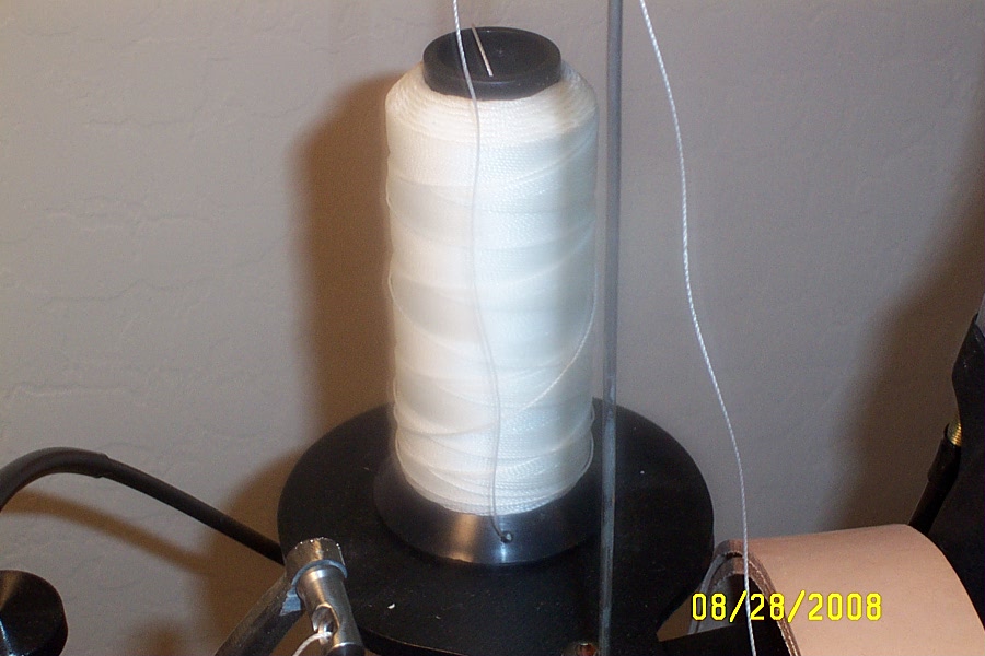

rickybobby Posted August 28, 2008 Report Posted August 28, 2008 I found this on Tippmans website, Drill a small hole in the plastic thread bobbin base. Run the thread from the top, down the inside of the bobbin, out the hole in the base, up to the thread guide arm to the machine. Try it you don't need to worry about looking like a cross dresser buying pantyhose, wires, garlic, or hairnets!! Rick J. Quote Rick
