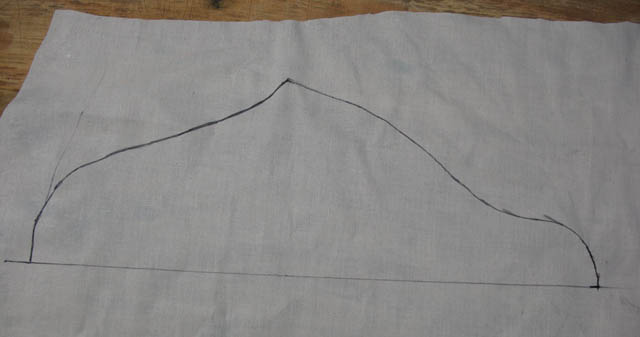

foamwork done. I use the.........for pattern making, i use
cheapo spraytac to hold...........whatever is on sale that
pattern material in place...............will work
i've used other methods,..........i reapply to mark next piece
but have found this is the
most accurate way to get
the odd shapes.

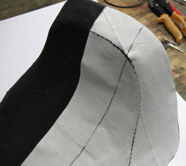

its best to use a somewhat........i can skip a few steps by
transparent cloth to be able.........marking holes while patterns
to see other piece ..................... are still on seat

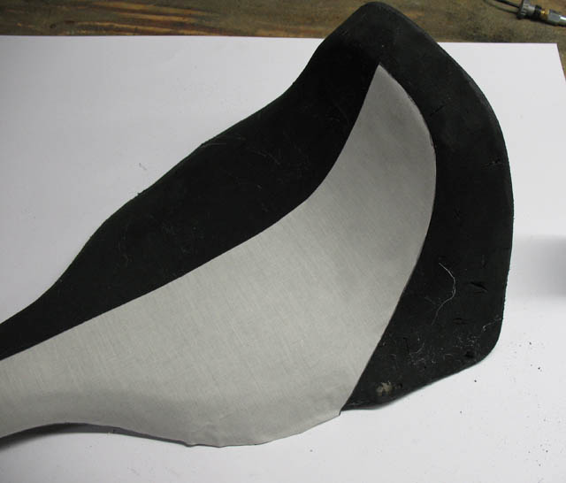

pattern is then transfered........paper still folded, i mark holes
to a folded piece of....................and (symetrical) design.
posterboard to lay out
design
paper still folded.......................leather cut w/design

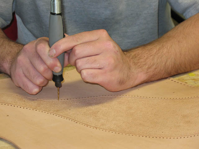

i press the holes to make
indent on other side

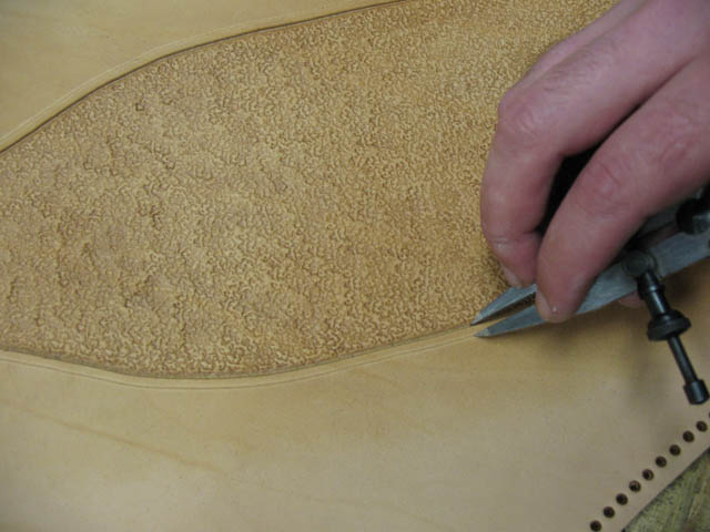

tooling done............................scribing stitching line.
i used to use my drill press,.......I hang it from the ceiling for
but this is alot less quicker,........two reasons: 1-keeps it off
easier.......................................of the work. 2-less stress on
..................................................hands and wrists.

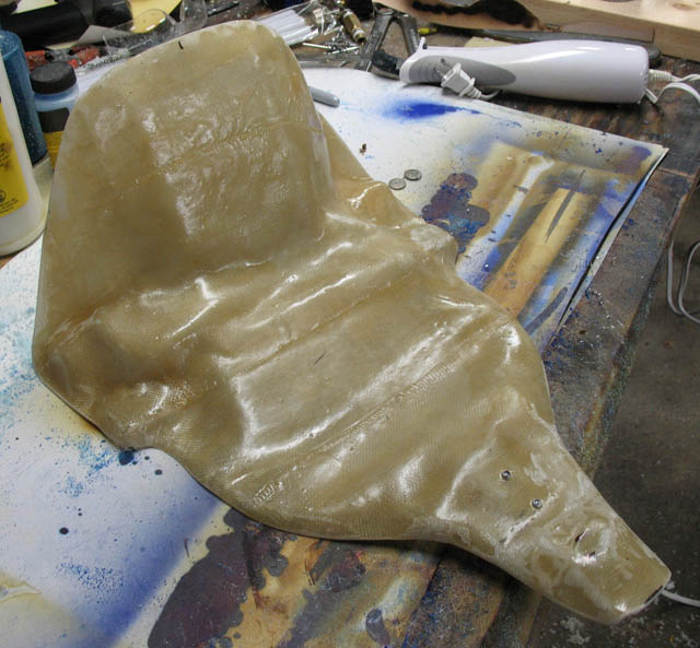

died, stitched, and laced. in.........although i can get my foam
that order.................................very smooth, there are still
tripple loop lace........................a few minor bumps and valleys.
.................................................I stretch headliner material over
................................................entire seat to smooooth everything
............................................... out. It also helps me to get a very
......................................................tight fit of cover.

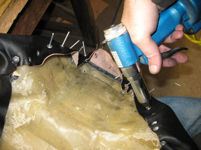

looks kinda scary huh.................thank goodness for air compressors
I finnished bottom with felt. Install mounting brackets. shine er up (leather balm w/atom wax)

What tool did you use for the inlay - really like the effect, and

Been looking at this seat tutorial a few times and now realize you are using the same air pop rivet gun I have gotten from Harbour freight....with the small detail that mine seems NOT to work....I can not figger out how much oil I need to put in where....The manual does NOT tell u the amount of oil....have added about a cup of hydraulic oil and made the biggest mess possible...oil on shirt and walls...haha....now very little oil in resovair
but still no go...it will not grabb the rivet and make a connection....any ideas what I do wrong...
