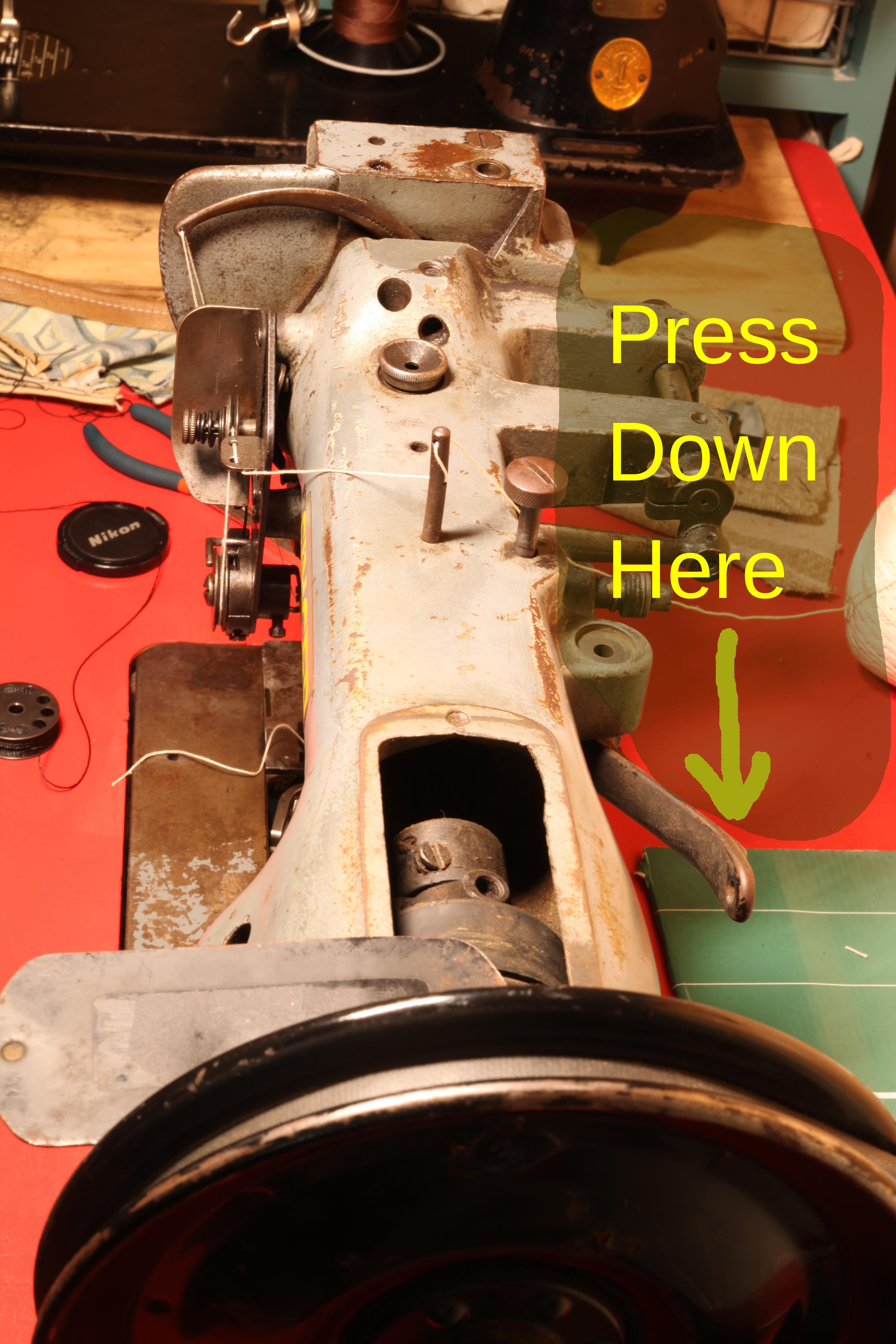

  2. This is normal. The extra work is going into compressing the presser foot spring. The effect goes away if you lift the presser feet. Mine does not lift as far when the inner toe is down. Maybe you aren't getting enough lift. Try pressing down with your hand on the far end of the foot lift bar and see if it comes up.
  3. Missing lock nut? My singer 144 has a lock nut on that stud.
  4. That was good help, thanks! Found the online manuals - parts, owners, and adjusters. All I needed!

  7. Beautiful!

  18. Google image search says it's a Singer 7-33. https://www.google.com/search?vsrid=CMGasciNpZWkahACGAEiJDA3ZDlkMGM2LTVlMDMtNGRiYS04NThjLTA3NDMzYjljNzZhYTIGIgJnaCgKOIz6m8nV9o8D&vsint=CAIqDAoCCAcSAggKGAEgATojChYNAAAAPxUAAAA_HQAAgD8lAACAPzABEIAIGIAGJQAAgD8&udm=26&lns_mode=un&source=lns.web.gisbubb&vsdim=1024,768&gsessionid=24dj2mh4nfiLTSphHqJfHudhqACKQKBxlDVm2yspEKbM25XhmrRn0A&lsessionid=U9iFFpQDbhz8KncIZ7XjX8c_1DDP_O5CbKsLDwO4GzJa1yPHkLRbRA&lns_surface=26&authuser=0&lns_vfs=e&qsubts=1758897977399&biw=1920&bih=903&hl=en#vhid=v6WRbHUhptf8PM&vssid=mosaic Here's the pdf for it. The 7-31 is similar to the 7-33 and uses the same manual. http://hensewfiles.com/PDFs/SINGER 7-31.pdf
  19. Thanks for posting! Your original artwork is superb. I especially like the belt. OK, it's a tossup between the belt and the satchel with the planets. Beautiful work.
  20. The Chicago screws are a good idea - for the next one. This older client's saddle was in good shape, and I am guessing that she had taken a break from riding and was returning to it.
  21. I've been asked to come look at this machine. They say they think it is "out of time". I can time almost anything, if that is the problem. Can anyone tell me the model? Any suggestions or resources? Thanks!
