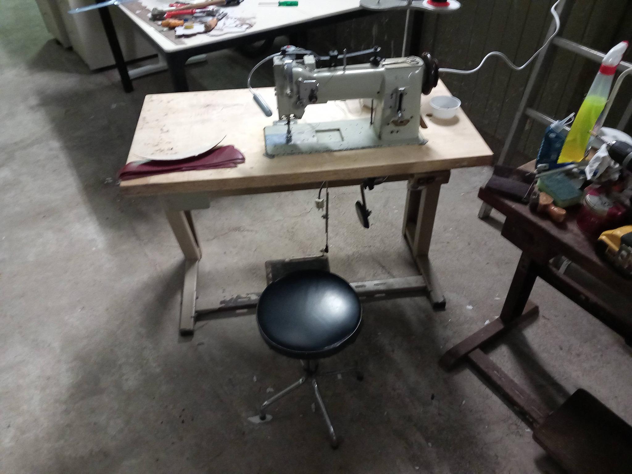

Hello all, I am Morgan. I own the following machine (see photo) and I’m trying to find its user manual. It is a USMC machine, and there is a metal plate marked 396F on it. Would anyone happen to have an operating manual, documentation, or any information about this model? Thank you very much for your help.
